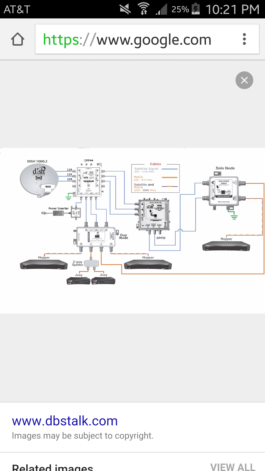

Hmmm, sounds like 3 hoppers is going to be the way to do this...
I guess I'm worried about the set up. Can our AV guy help with the install of the 3rd hopper?

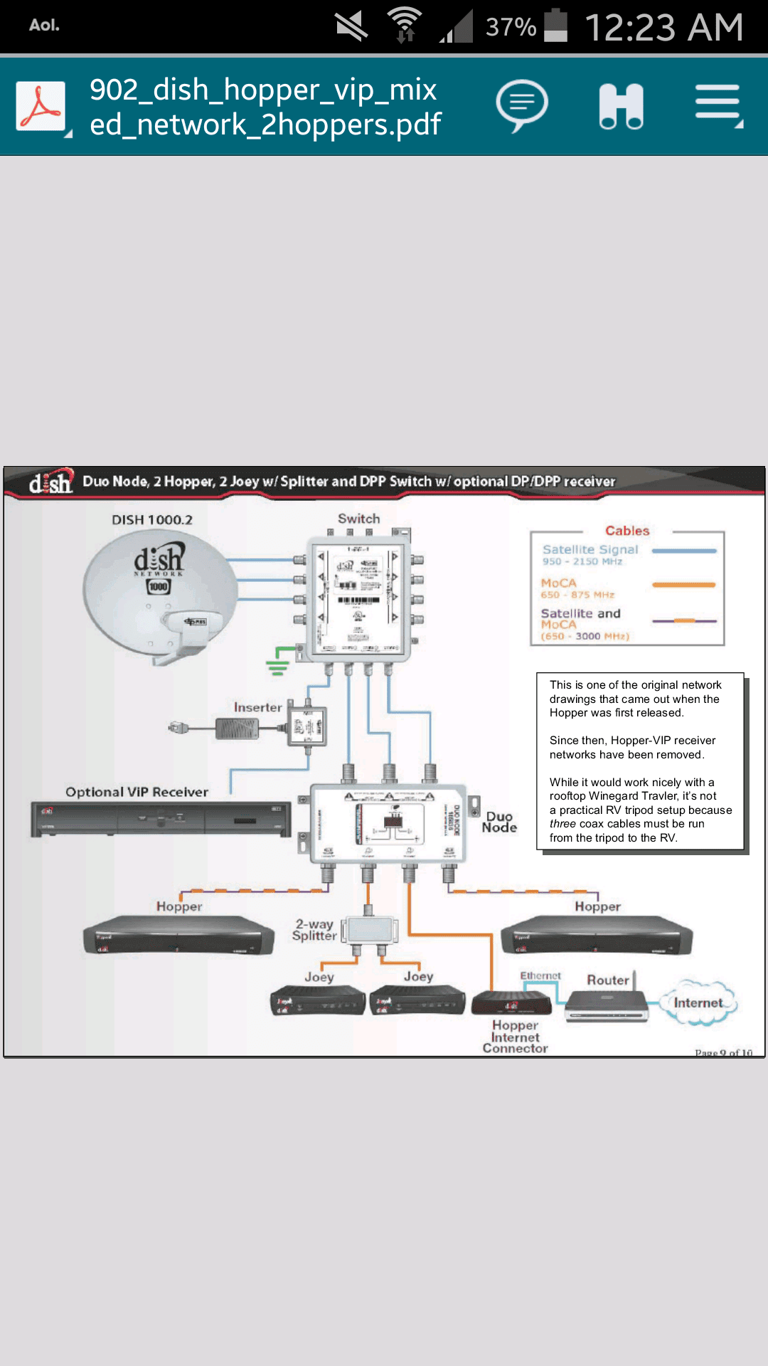

Or, maybe we can do 2 hoppers and a 211, and 2 joeys if I'm worried about the install. The issue is when we have guests (who come and stay for a long while, using the guest bedroom and the bonus room most likely).

I would go with the 2 Hopper 2 Joey with the 211k or Z for the Guest room.

I think we'll do the 2 hopper, 2 Joey set up and then buy the 211 for the guest bedroom.

Absolutely, but you'll need an extra switch. Dish installer will take care of everything. You will need to purchase the 211 on your own for use with the Hopper system.
Yes Just make sure you have the 211 before the tech arrives.
He will install a DPP44, It requires a Power Inserter, which he will most likely connect with the VIP 211.
Also make sure you let dish Know you want him to connect the 211, just to make sure he has the proper supplies.
And remember, call and verify everything, because you are not a New customer.
They may charge certain fees, they may not for this upgrade.
When mine was installed, Dish only did the Hopper install.
But they would have done the VIP as well, If I would have had it in time.
So I had to do the DPP44 and 211 myself.
Not to difficult, but there are certain steps and wiring moves that have to be a certain way, or the Hoppers get screwy.
But if you decide to do it yourself, we'll be glad to help.
Oh , and the Hoppers are Good, so far no issues. The Joeys are Hit or miss,I have one that's Okay, and one that is slooow.
