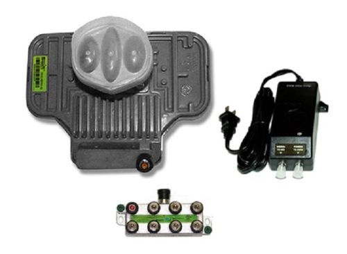

so this would be fine? only changing it because I will upgrade eventually and I want to replace all the coax so if I am doing that then I might as well go with swm and 1 wire to the lnb

Thats the older analog Slimline-3 SWiM Ka/Ku band model which supports up to 8 tuners.
It will work fine with your present setup of only 2 HR24s, but not a good selection for future proofing.
I would recommend one of the new digital 2nd gen. Reverse Band capable SWiM LNBs with up to 21 tuner support such as here.

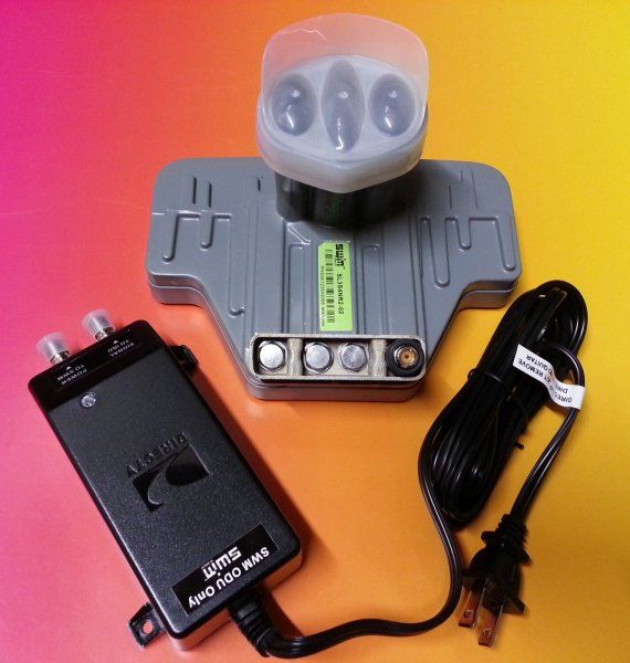

sorry I posted the wrong picture, this is the one I was looking at. I read somewhere that eagle aspen made was the best. but if the one in the link to solid signal is good then I will look for en of those type

That is one of the new 2nd gen. digital SWiM LNBs, with up to 21 tuner support.
But has no Reverse Band capability ....
So if you don't think you may upgrade to 4K service anytime soon. Then it will work fine for now and the future ...

ok, thanks I have no plans to get 4k yet but if I do then I am ready so I will get the reverse band
It's 13 channel support. It can't do 21 channels ...
