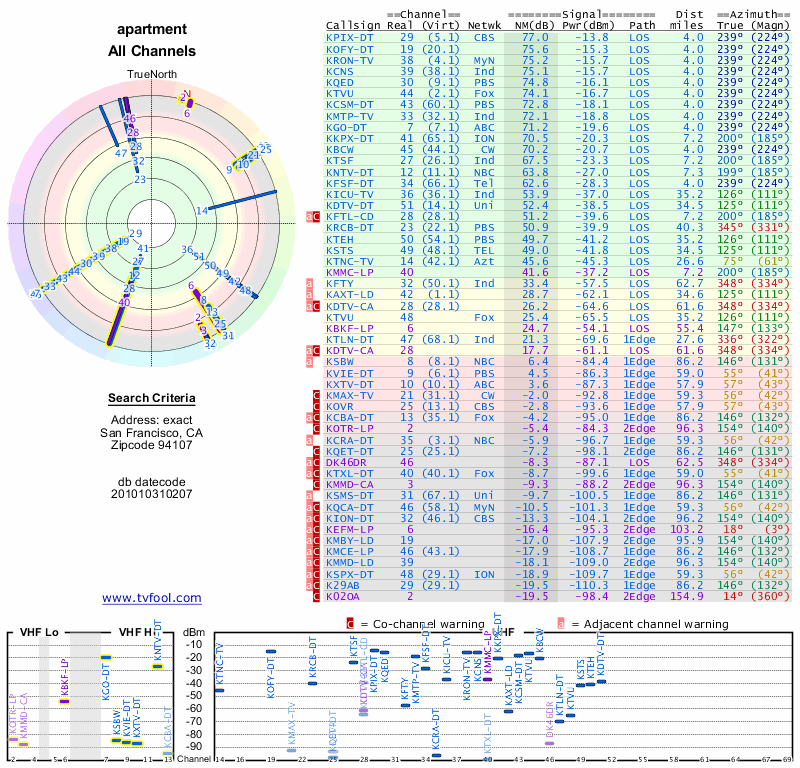

Thanks for the TV Fool website. I never knew it existed. RCA gave me antennaweb's website after purchasing one of their antenna's. Here's the image from the site.

94107 zip shows all major networks are 4-6 miles from your apartment complex 14.1 is 33 miles away. It would really be nice to know what RCA antenna you have, RCA makes many antennas from cheap junk to very good products. As close as you are to the broadcasters you are going to have too much signal. With your drawing that signal is going to bounce around that complex and cause ghosting, reflected signals interfering with the main signals. This may sound stupid but strip about a foot of shielding off the end of a coax cable just leaving the bare copper center wire exposed. Now connect it to the TV and see what you get for reception, you have much more signal than you need being so close to the broadcast towers.
