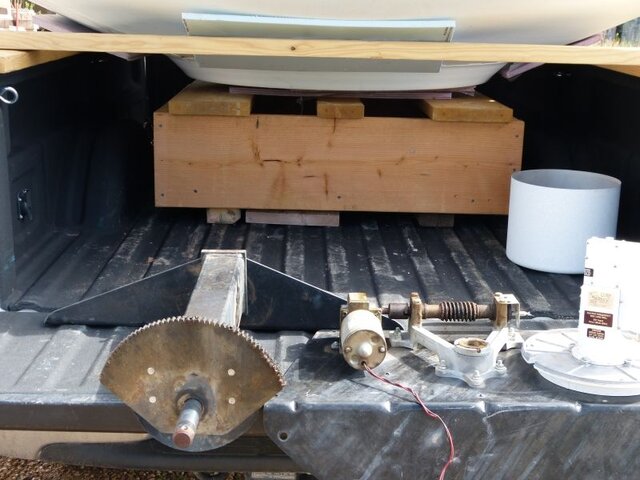

This one has a reed switch, rather than a pot. I'm getting 12 pulses per revolution of the worm gear. My actuator controller counts on both the rising and following edges, so I will get 24 counts per revolution. Not sure this is good enough for Ku?
I'm looking at doing all the usual mods, moving the feed higher, reaming out the scalar for a modern LNBF, etc.
A few other things I noticed are no fine adjustment rod for elevation and no limit switches. Kind of surprised by that.

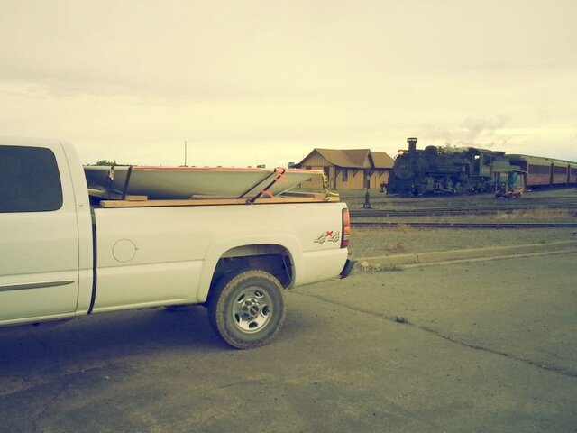

Here are a few photos, didn't have time to take more.
It's a great signal catcher and a real strong mount, but it does have it's limitations unfortunately.
What? did you take that back to the past;) I see a steam locomotive and it's fired up in the background. :)
