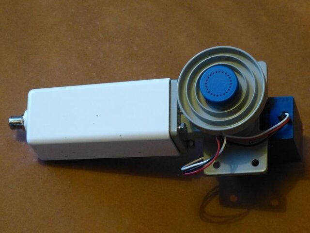

I'm using an Invacom C120 (single output) for KU. I was considering getting a multiple output, but I'm not sure how much of a performance loss (if any) it would be. Which KU LNB are you planning on using?
I'll be using a Chaparral Ku only Polarotor with a Norsat 1107HA LNB. Has anyone compared this to an Invacom?
I'm using a pair of 1208HAs on my Bullseye II. I'm real happy with them. :)
