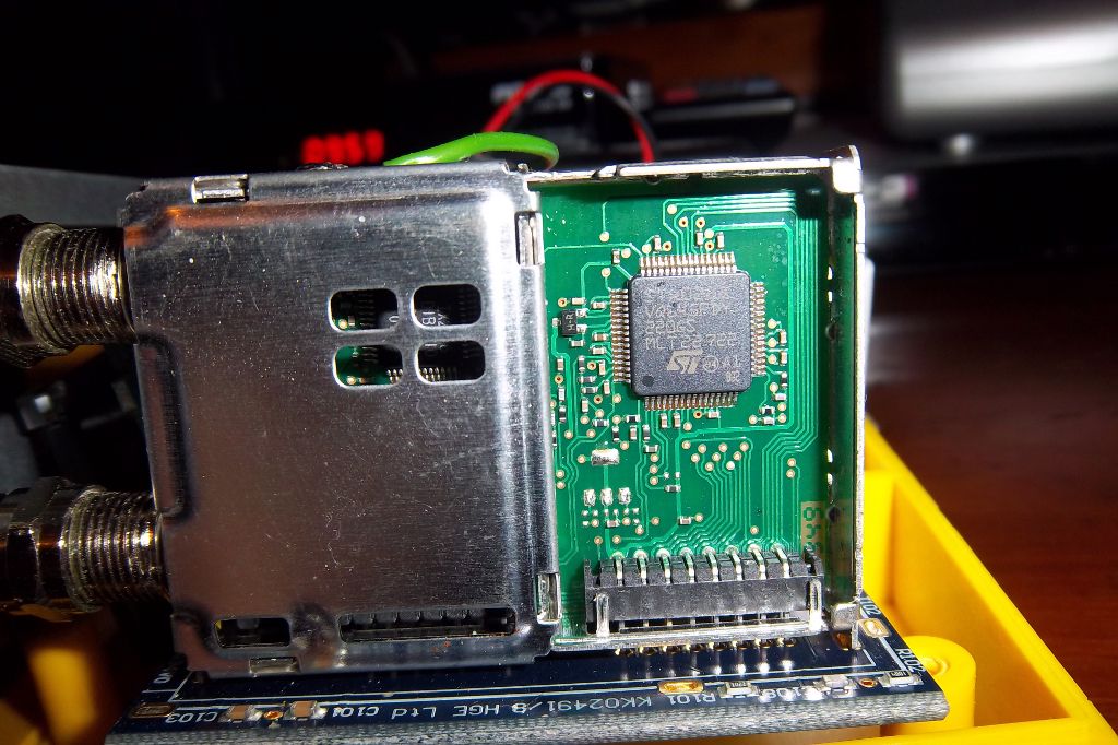

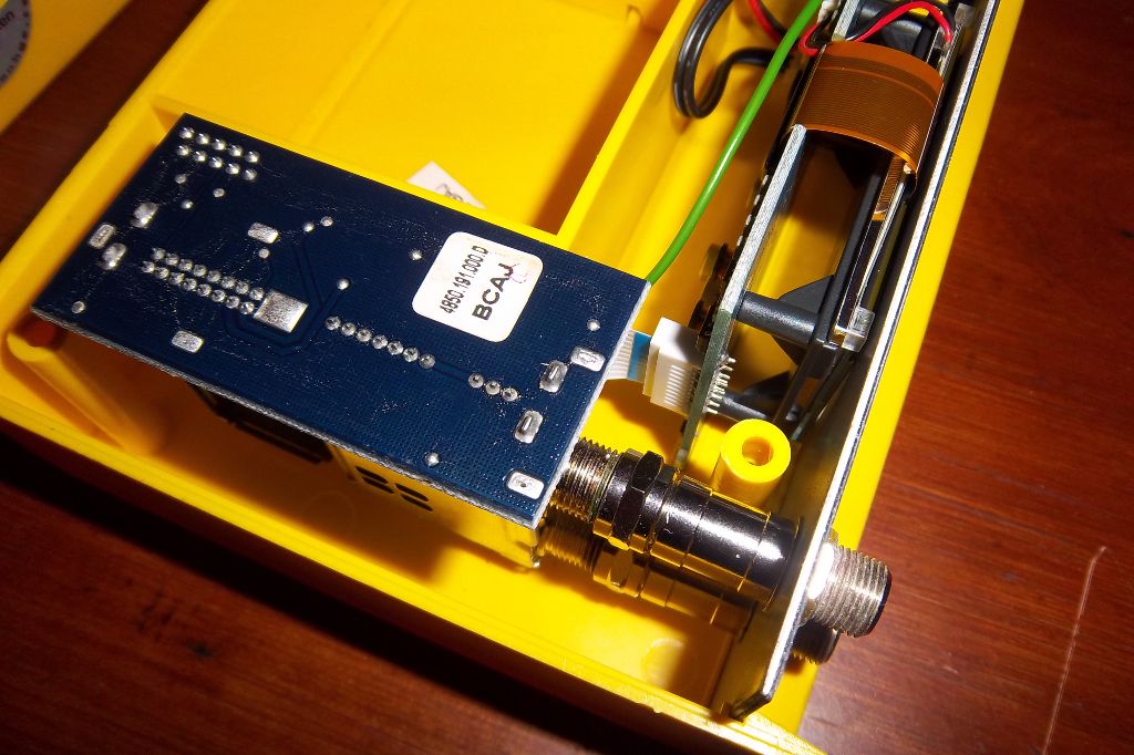

Can you post a picture of the tuner module? Is there a label on the tuner itself with a part #?

Thanks for the reply. No dish, directv or hughesnet on the meter - I've loaded sat lists three different times: once for ku standard, once for ku universal, and once for c band - all FTA stuff - no dish, directv or hughesnet with any of the lists. Here are some pics of the tuner:

Couldn't find any info on that tuner. :( I was hoping to find some info so you could check voltages and etc. on the tuner, but nothing, unless I read the # wrong: 4850 191 000 D ?
One pin on the tuner I think should be a 12V or 5V supply and a gnd somewhere, maybe the case, some tuners use 9V, but not very many. If you don't see a supply voltage, you could look for a possible bad voltage regulator on the main board, bad cap, etc. At a guess, I'd think that tuner would be 5V. Possibly might find 33V too. This is kinda guessing, because I'm familiar with TV tuners and not at all with satellite tuners, so I could be all wet on this!

Yes, #4850.191.000.D (with . between each number/letter). I had looked as well and couldn't find any reference to that part # nor could I find any kind of schematic or service manual for any model (must be pretty well guarded info;)). I know the ground wire is there (connected to case) and has good continuity. I will check main board closer and look for voltage regulator part #'s, etc and see if output concurs with ratings (been avoiding doing too much without service info for fear of doing more damage than good but what the heck, it's not like it's gonna fix itself).
