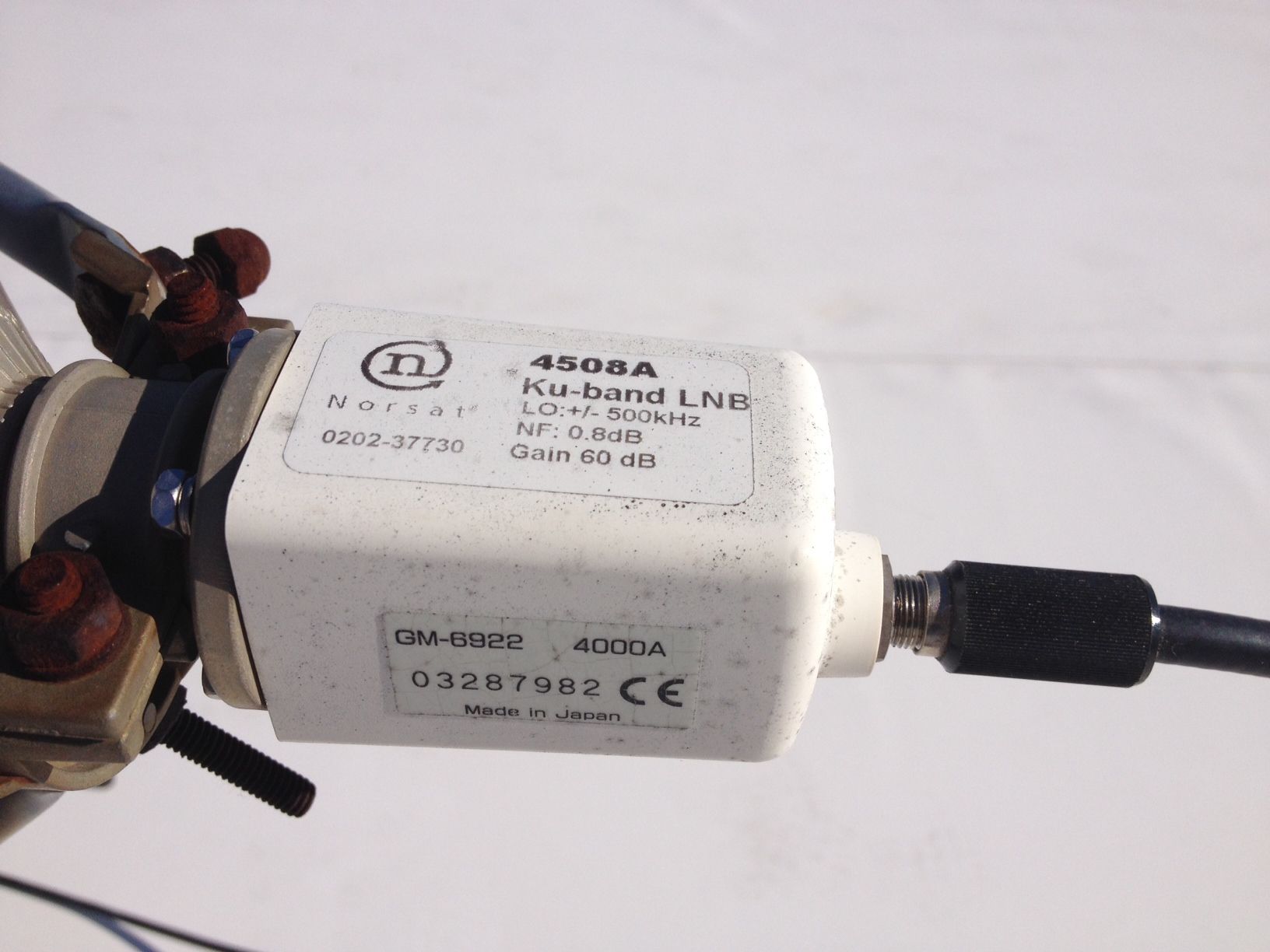

I tried about a dozen different selections for this LNB, and could only get a noise floor. Granted, I was there for a service call due to possible dish malignment, so maybe it just wasn't peaked at all. When I tried to adjust the dish, the critical elevation bolt snapped off instantly (rusted clean through). So they ordred a new dish/LNB.
But what would be the correct setting for something like this on the Supper Buddy (actually AI Turbo S2)?
NORSAT 4508A KU-BAND DRO LNB
Input Frequency: 11.7-12.2 GHz. LO Stability +/-500 kHz. Noise Figure: 0.8 dB. Output Connector: Type F Female. L.O. Frequency: 10.75 Ghz. Conversion Gain: 60 dB
Select service "generic ku band" system "H/V singl pol LNB" select LO= 10.75 11.7- 12.2 from looking at my AI TurboS2
