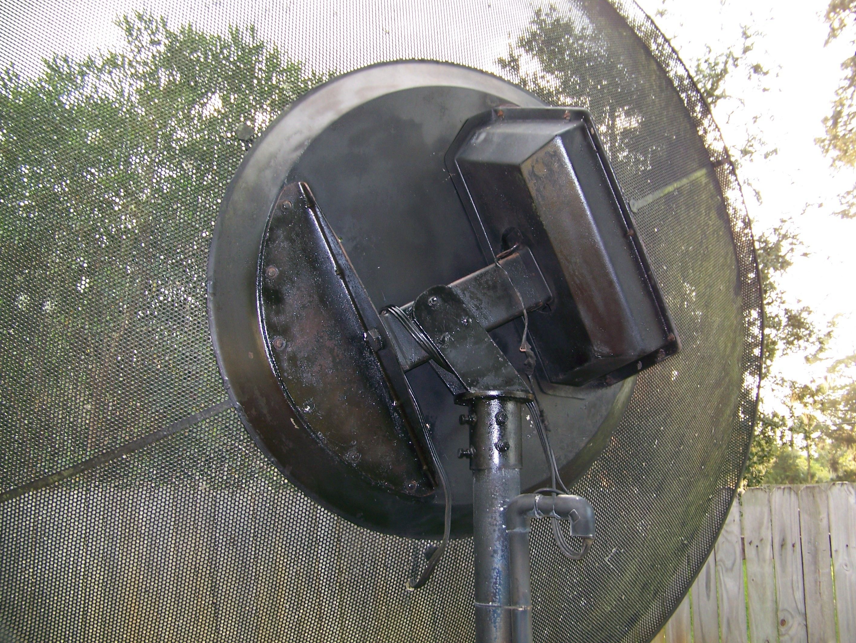

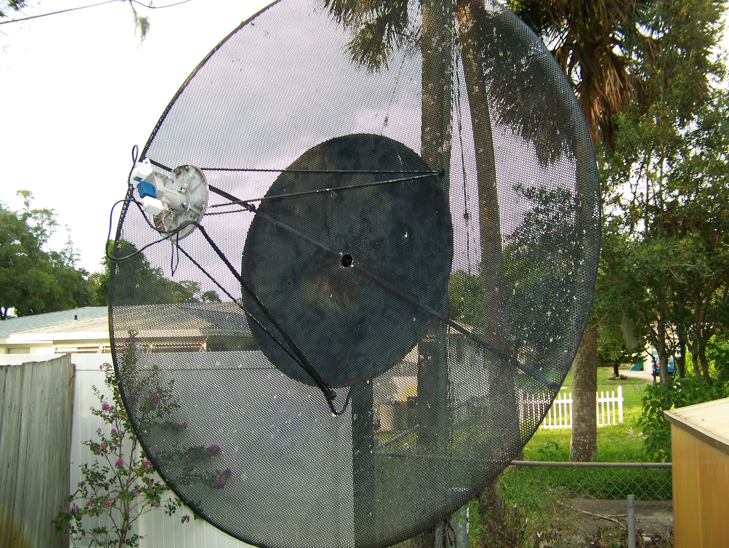

I have attached two pictures of a 9.5' dish. I would like your comments regarding the small hole located slightly below the lower support rod. There appears to be coax passing thru the hole. Was this dish originally manufactured with this hole or has it been added?

All Birdviews have a stock hole.
Not sure if that's where it should be, but it does look original.

Usually about 2 o'clock, facing the dish, at true south, near the LNB support struts.

Your dish appears to be installed upside down on the mount, relative to all other BV dishes I have pictures for.

Hi Mjac,that is the factory hole for the wires.Also the hole is in the same spot on my perf Birdview so I don't think it is upside down. I am going to my house in S.C. next week and am hoping to finish setting mine up.
