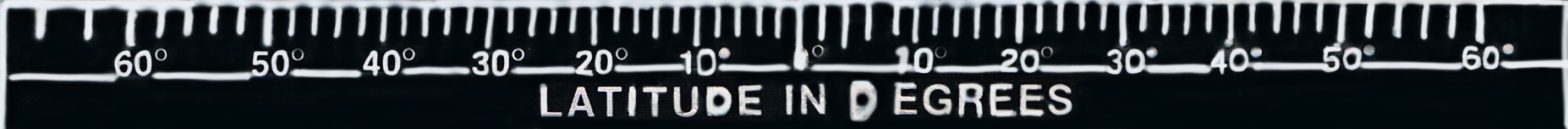

Hello a while back a member (brex2001) had posted a picture of the scale for a Orbitron SX-10 Dish
I redid it today hopefully this will help anyone who has this dish and the scale is no longer on it...

I guess you didn't understand what I was saying, I took the picture that was posted a while back and used photoshop to restore it, then printed it out and going to laminate back on the dish.
