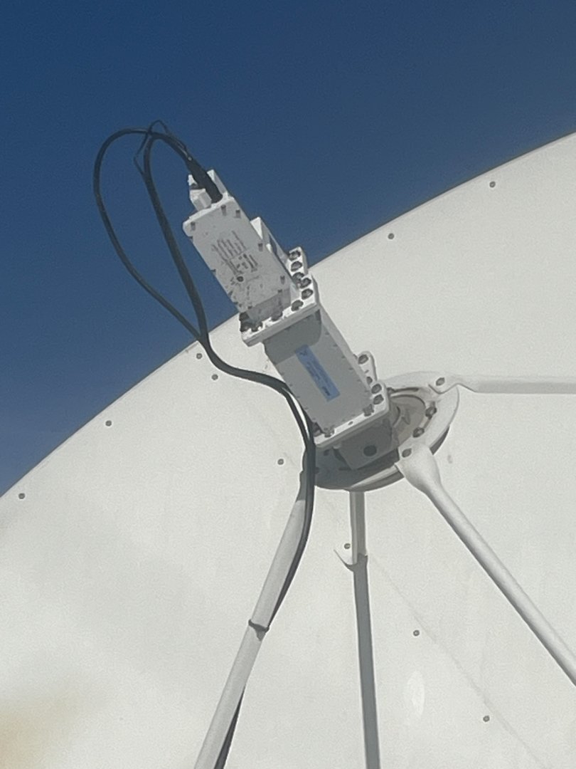

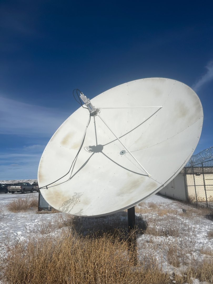

The alignment is occurring because the antenna was pointed at Galaxy 33 at 133 W instead of SES 1 at 101 W.
Attempting to connect to SES 1, Transponder 16, 4020H.
The LNBs currently used are NORSAT 3020s
For alignment, I use the XR3 directly to the LNB, which powers the LNB.

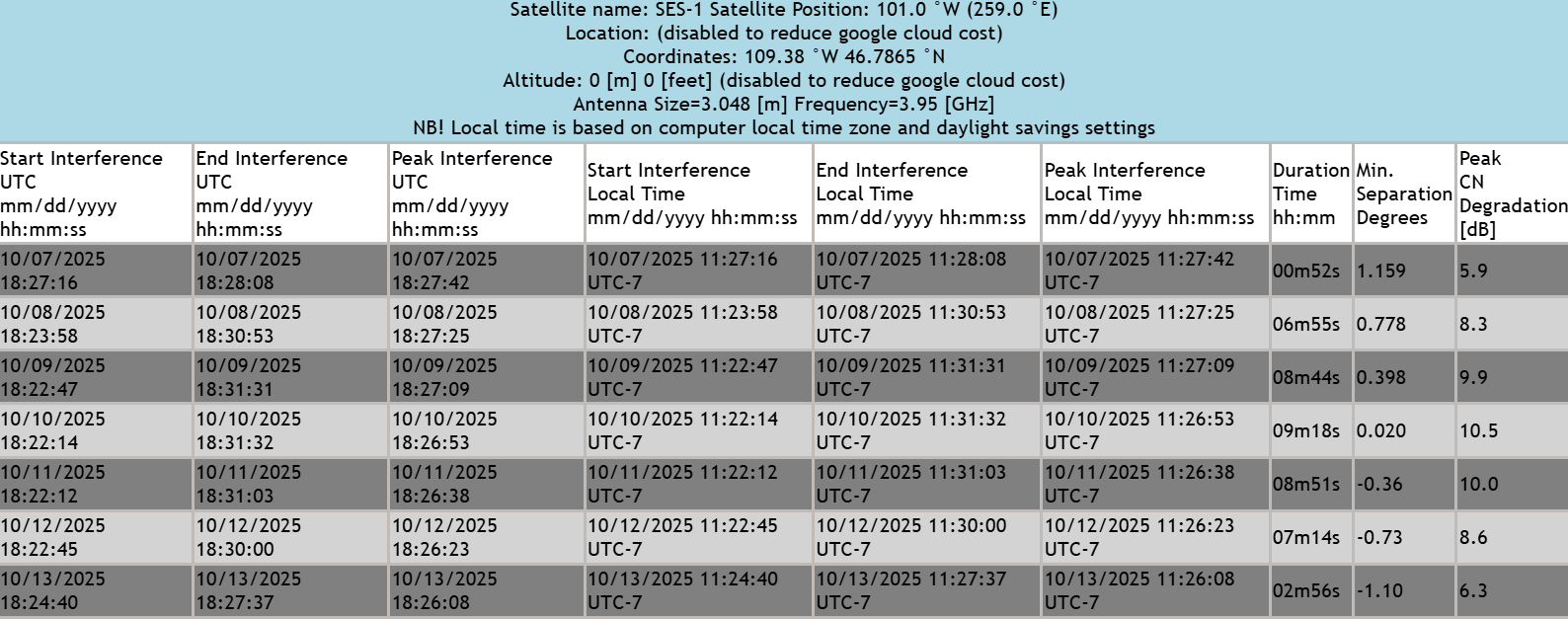

Were you doing this work today? I ask because at your area there were seasonal solar outages around midday up until Monday this week.
I first attempted to realign this antenna last Friday 10/10 then again on Monday 10/13 and today. I normally work on the system from 1100 to 1500 (3pm) local time.

Of course you adjusted the lnb skew angle to compensate for the movement. Right?
What part of the mount structure are you using the measure the elevation? If stamped in numbers, how do they compare when previously set to 133W? Spot on or off a little bit?
The skew change is important. In Montana, moving the dish from 133W to 101W, you need to rotate the LNBF by 28 degrees CCW looking from behind the dish. Until you do, you won't receive signal.
Aiming for the stronger 4005 V 4442 transponder is smart too.
Arlo,
There is no indication of elevation on the antenna. I use my phone and a "level Bubble" to determine the skew of the antenna.
