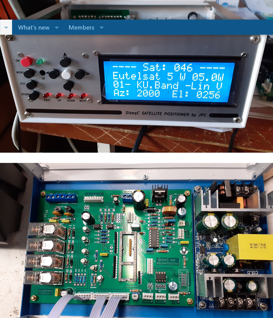

Actually if you contact dreambox 1959 on satellites.co.uk he might build you a better-than asc1. Not quite sure is it incorporates skew control for a polorotor.
RC controllers are robust and relatively cheap on eBay. Schematics and software are fully supported. I contacted them and asked if anyone had a diseqc interface. They have a lot of third party software developers. There are options for TLE satellite tracking if that's you desire and use an az-el mount.
But nobody I contacted was familiar with diseqc at all.
Then looking at the software reference manual and command string. Since there are Arduino diseqc projects. No hits on suggestions so far. A transcoder interface to receive and forward commands to the RC mover would do it.
Yes. An h bridge and external current limited power smps with would help a vbox live I would think.
More elegant and less parts would be one made from solid sate relays. Motor reverse polarity could be directly applied to the SSR inputs with current limiting resistors. Because the trigger side of SSR's is simply an LED.
You could do it Klipsch crossover style on a fancy piece of mahogany or oak. A Meanwell SMPS...you're golden.
