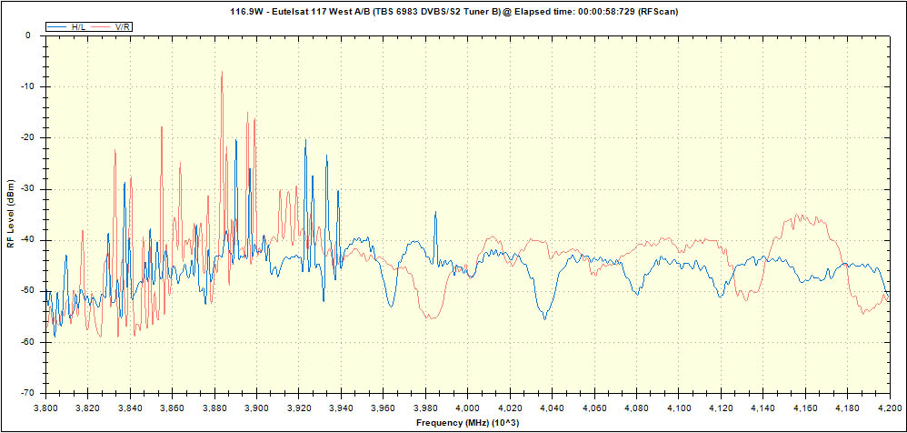

This first signal graph is from an older LNBF that has a pass band of 3,800 to 4,200 MHz. As you can see, the 5G signal spikes at my QTH are quite strong!

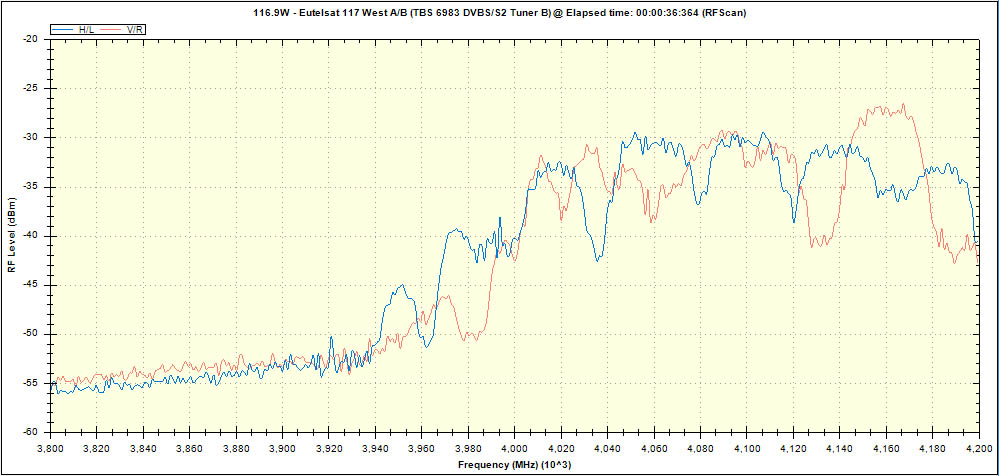

The signal graph below is from the new Titanium C140 LNBF, taken from the same dish and the same satellite as above. It filters 5G very well below 4,000 MHz.
Graphs are useful, but the most important consideration is how well do these LNBFs perform with actual FTA TV viewing? I scanned each satellite from 103W to 139W and I didn't see any reception glitches.

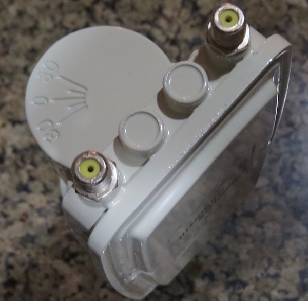

When mounting these LNBFs, the "0" mark on the back should be adjusted so that it is horizontal (parallel to the horizon).

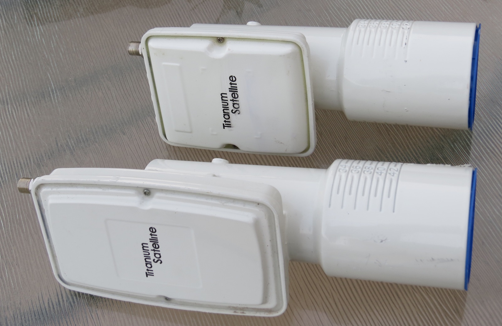

The photo below compares the size of the C140 (in front) with the older C138. You can see that the C140 has a larger circuit board container, which is very well sealed to prevent moisture intrusion.

Aside from differences in frequency filtering, how does the signal strength from 4000-4200 MHz compare between the C138 and C140? If I'm understanding the graphs correct, the C140 looks like it has better signal?
They are about the same signal strength. But I can see how you would think the C140 has higher peaks --- the vertical scale of the graphs are different (5 dB vs 10 dB on the left side).

My first signal graph in post #1 is 117W with a 3800-4200 C138. 3947 is not receivable here with either the C138 or C140 -- there is simply too much 5G at my location. However, with the C140 I was able to receive as low as 3972 on 117W.
... If you don't want to buy a TinySA, there is currently a TBS6983 on eBay for only $49 !! (It's not mine, but it is a great deal). The seller lists it as a "Quad Tuner", but it is actually a dual tuner. Still, for the price it is well worth it. I use my TBS6983 with EBSPro and the EBSPro mobile app to fine tune my satellite dishes. Also used it, of course, to make the signal graphs in this thread.
Anyway, yupidixie, if you are somehow able to get 3947 I will be interested to know how you did it. Before I got a C138 I tried blocking 5G with wire mesh, but it turned out to be a futile effort and a waste of $100.

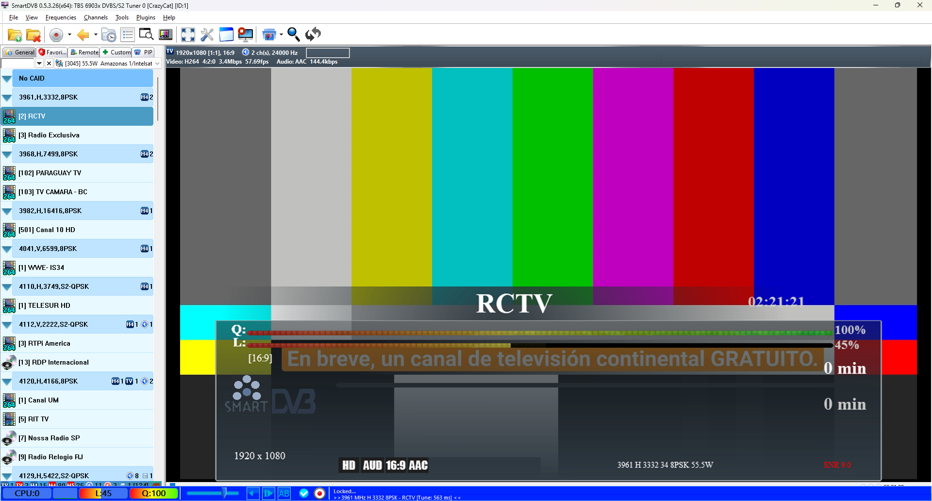

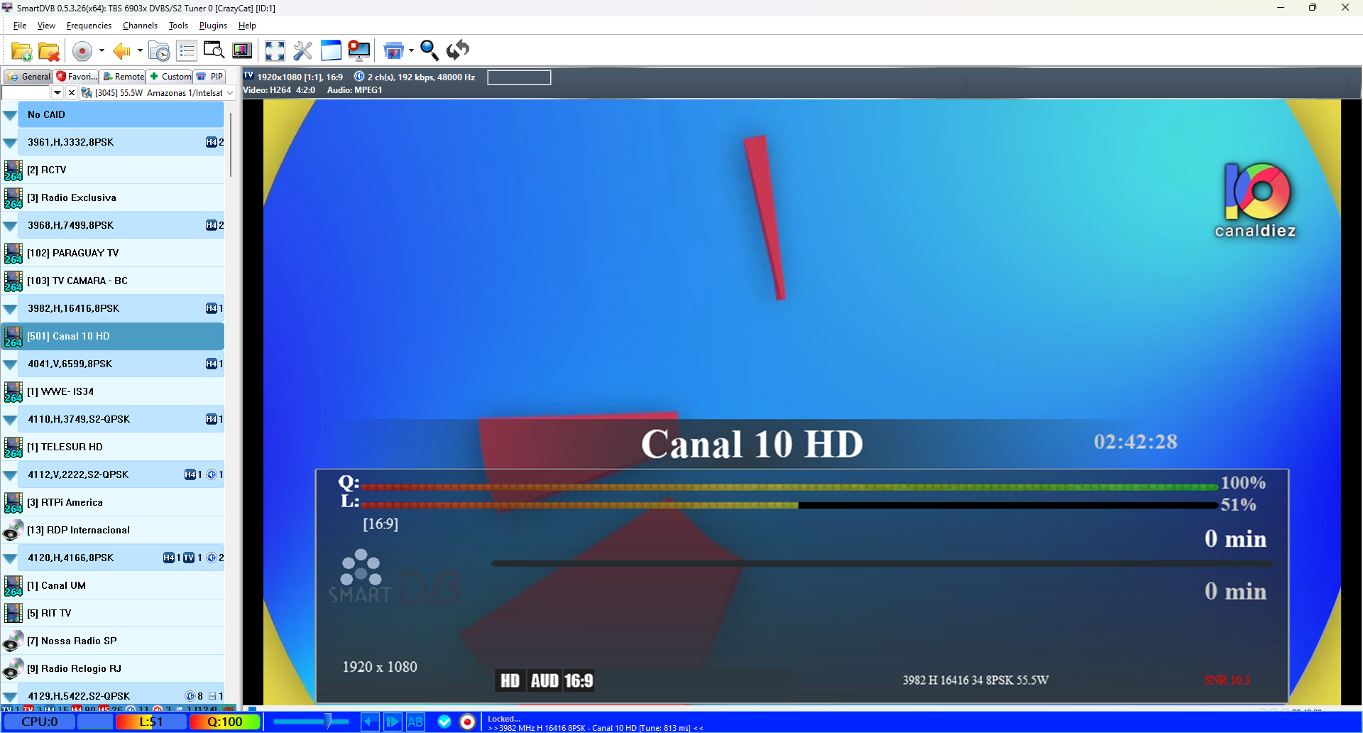

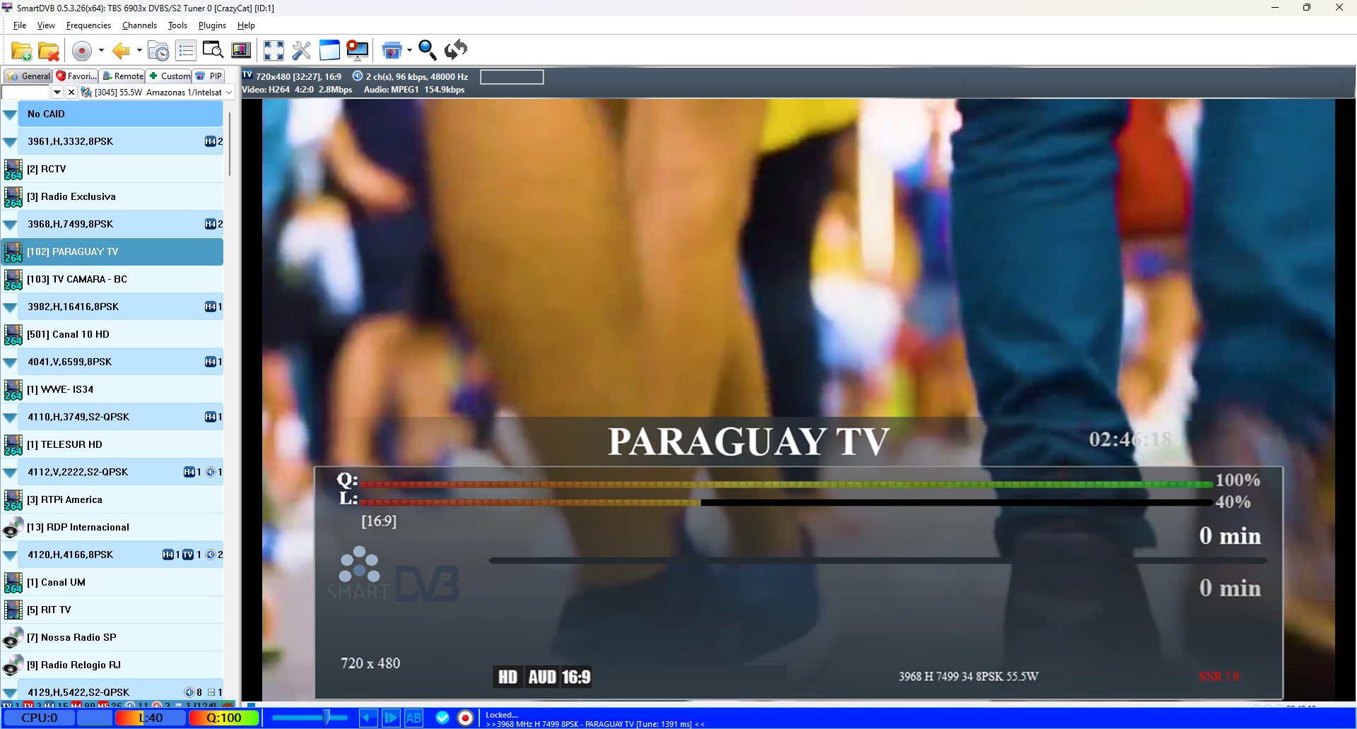

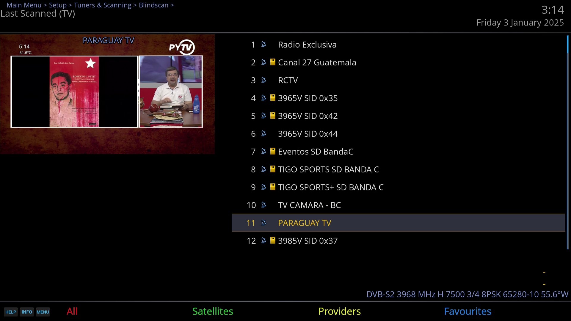

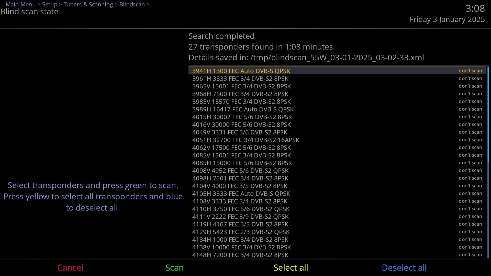

@ the red Highlighted: The Titanium C240, for some reason may have defied the odds as I'm able to scan, log and play the video without interference on Octagon SF8008, and TBS6903X. See attached screenshots.
