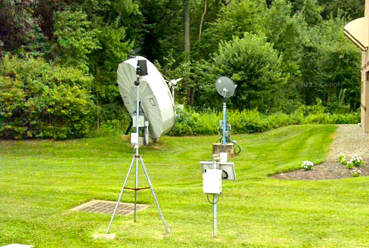

I live practically right next to two 5G towers and when they went live they wiped out everything on C band. I installed the C140 and have watchable signals again with one exception; aircraft radar. I'm in the flight path for two major airports and when the planes turn around over the pacific and head back towards land the radar signals completely overwhelm the LNBF. Watching it on a spectrum analyzer is quite the sight to see. Do you have any radar installations in the vicinity?

None that I know of.
This was very interesting to find. A NOAA weather station outside of Philly. Aimed most probably at 121W on the NOAAPort tp.
Never really saw a shield on anything but microwave link dishes on towers.
Pretty cool, huh!
