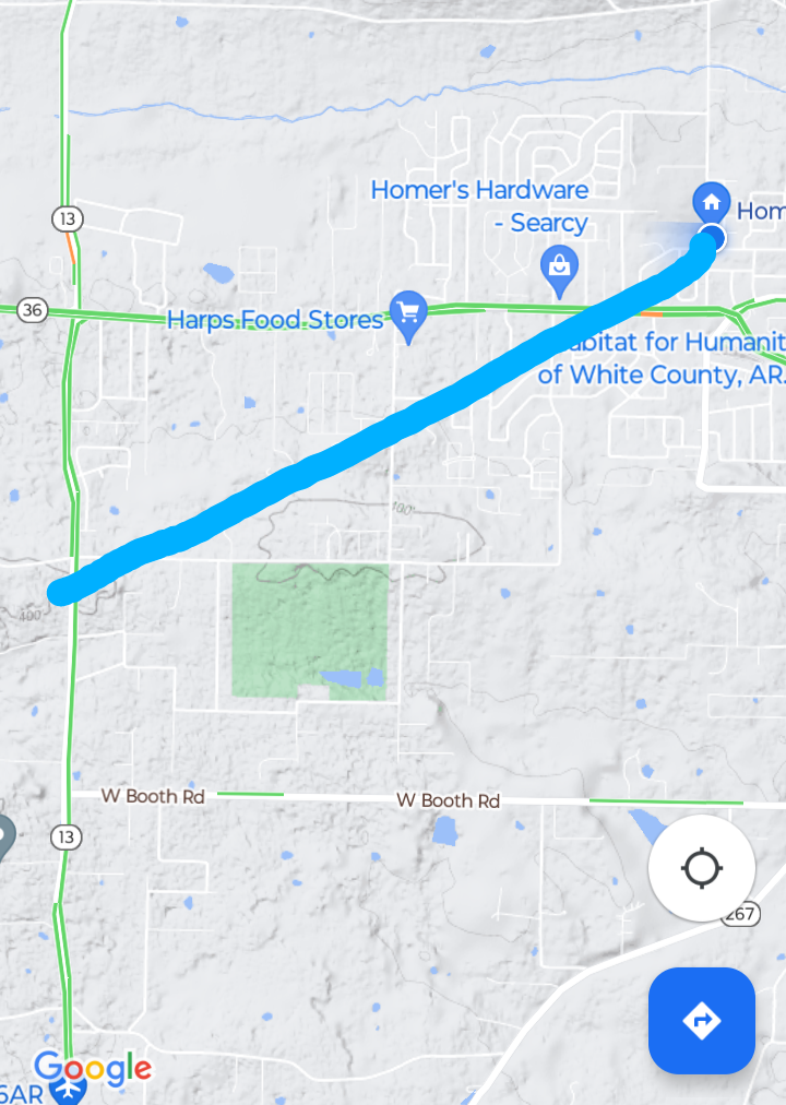

That is what I started wondering about after discovering the "performance plus" thread. The issue is that the interference is likely coming at the dish nearly head on when I am facing the western side of the arc. I need to verify the source, but I know this tower is 5G active. If it's from a 5G home hotspot, I may be SOL.
