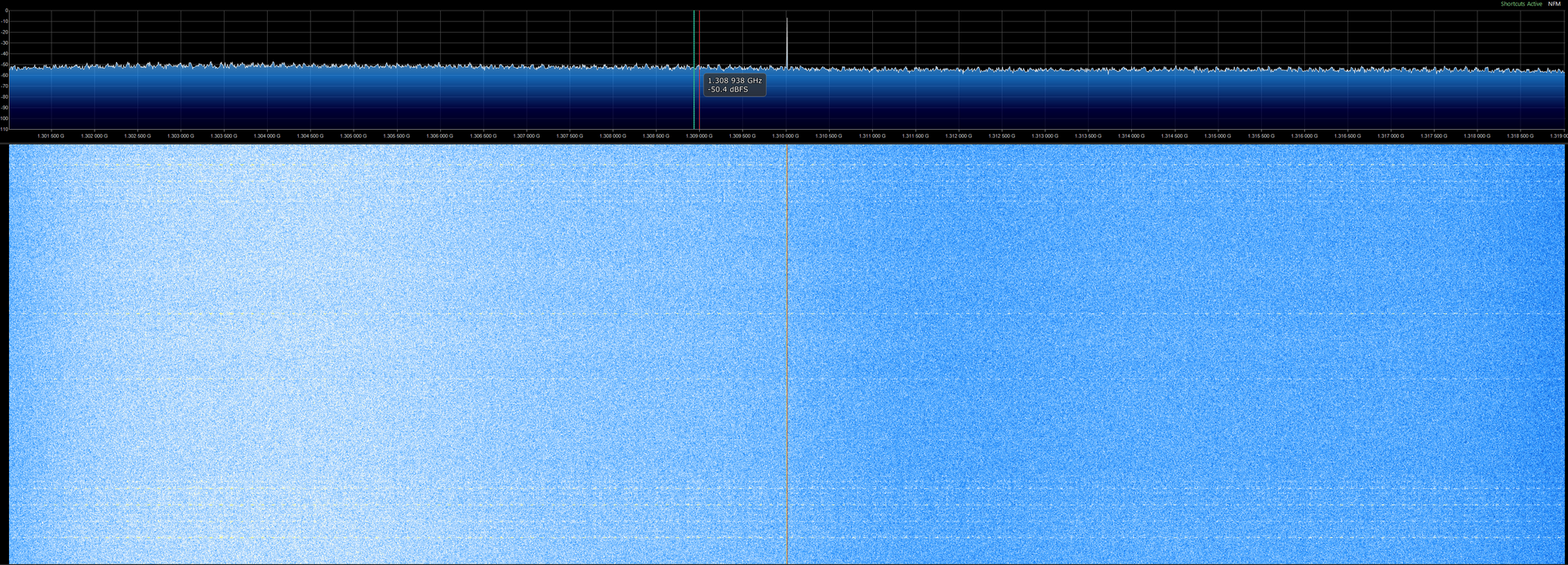

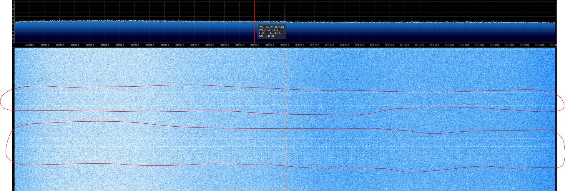

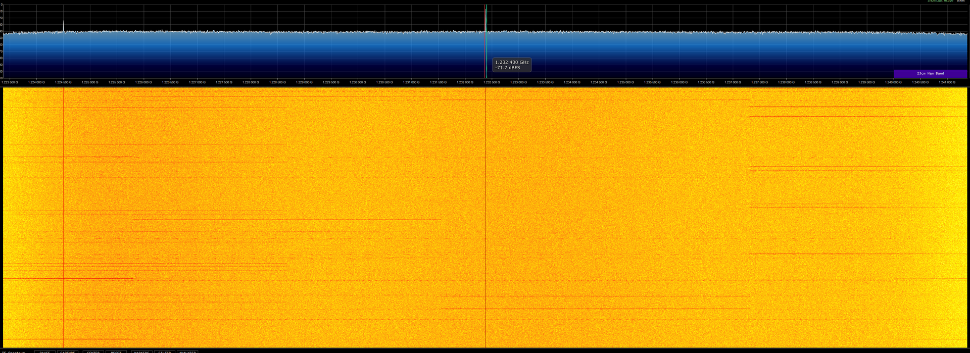

I've noticed some odd interferences on certain C-band frequencies causing the receiver to lose lock on the transponder. Does anyone know what the possible interference circled in the red box might be? The frequencies displayed in the image are downconverted, and the LNB is a Titanium Satellite - C1-PLL C138 with a 5G filter.

Need more information than still screenshots of carriers occurring within the bandpass frequency range of the LNBF.
Are these originating from a satellite? Terrestrial? Duration? Carrier width? Varying amplitude? Modulated? What transponders are affected? Complete transponder loss? Random micro-blocking? Fluctuating loss of decoding?

There is no satellite based 5G in the C-band frequency range. The 5G C-band frequencies are terrestrial based.
Time to hook a spectrum analyzer to your LNB and see confirm the presence and source of the interference. You will likely observe carrier spikes above 1170 MHz IF (3980 downlink - 5150 LO = 1170 IF)
