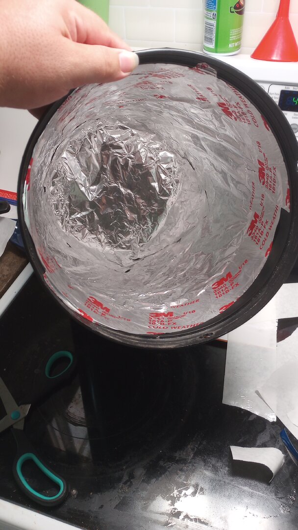

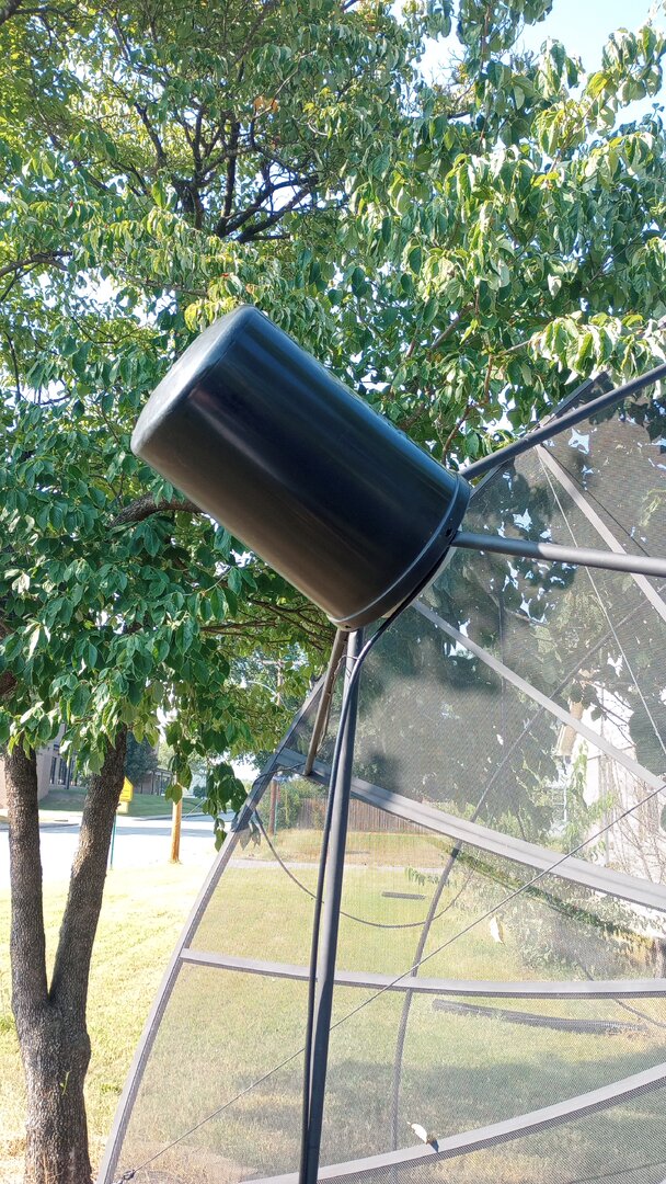

The Performance Plus LNBF is still working well for everything 4.0ghz and up. I'm just bummed that I am having issues with the FTA Weather Channel on 127w. But I did try something that does help a little. Much less errors with my Faraday LNB Cover.

That's pretty cool! Might work even better, IF you can ground that added foil with a wire going to a ground rod.

Is that ordinary aluminum foil? I think I still have the LNB covers but I don't normally use them.
I like your idea and would like to give this a try with my C-band dish. I wonder if there is a spray on product that would provide the same result as the aluminum foil?
I'm not sure. I don't quantitatively know how much the foil is helping to be honest. I'm just throwing ideas against the wall and seeing what sticks.
