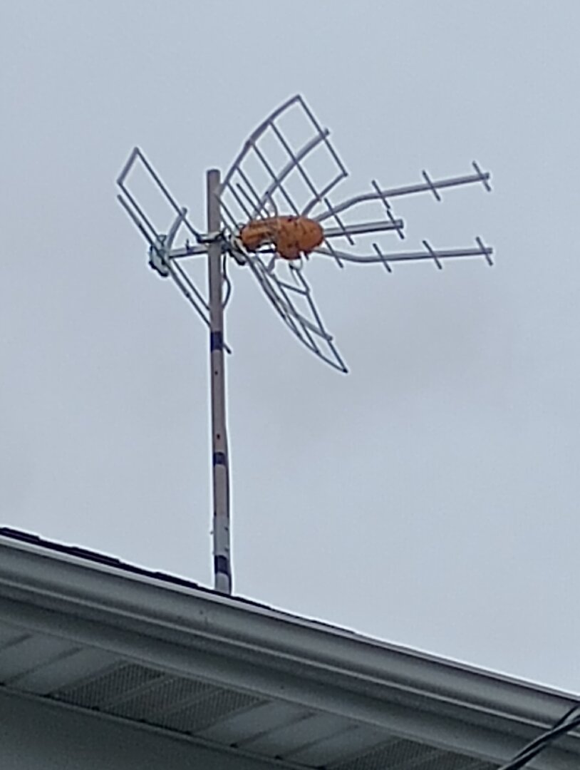

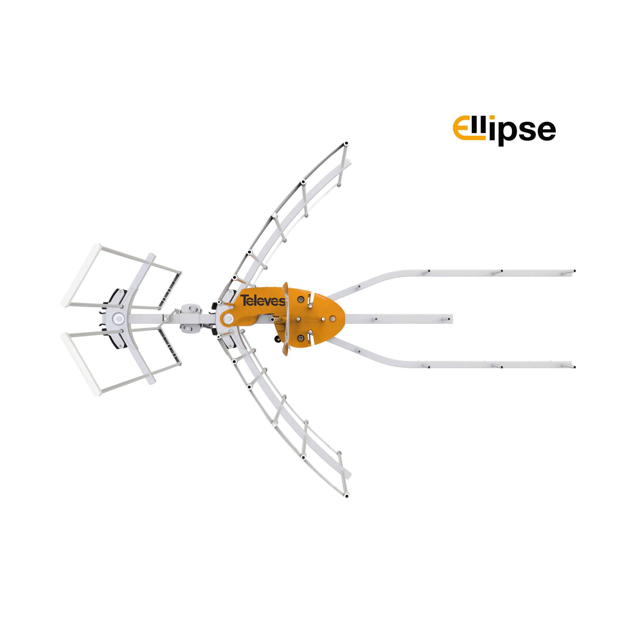

Get this antenna, (it's the latest model and version, completely re-engineered) and I'll bet your stations will all lock in nicely. I tested one, and it's the most powerful yet on the smaller side antenna I've ever seen. I had NO issues picking up stations at 50~ miles using it. It'll fit on the same pole you now have your 2V on. 5g/LTE and FM filters built into the dipole preamp.
Specs: Antena Ellipse Mix High-VHF/UHF (Repack Ready)
Installed at my sons house:
Reactions: Bahnzo
