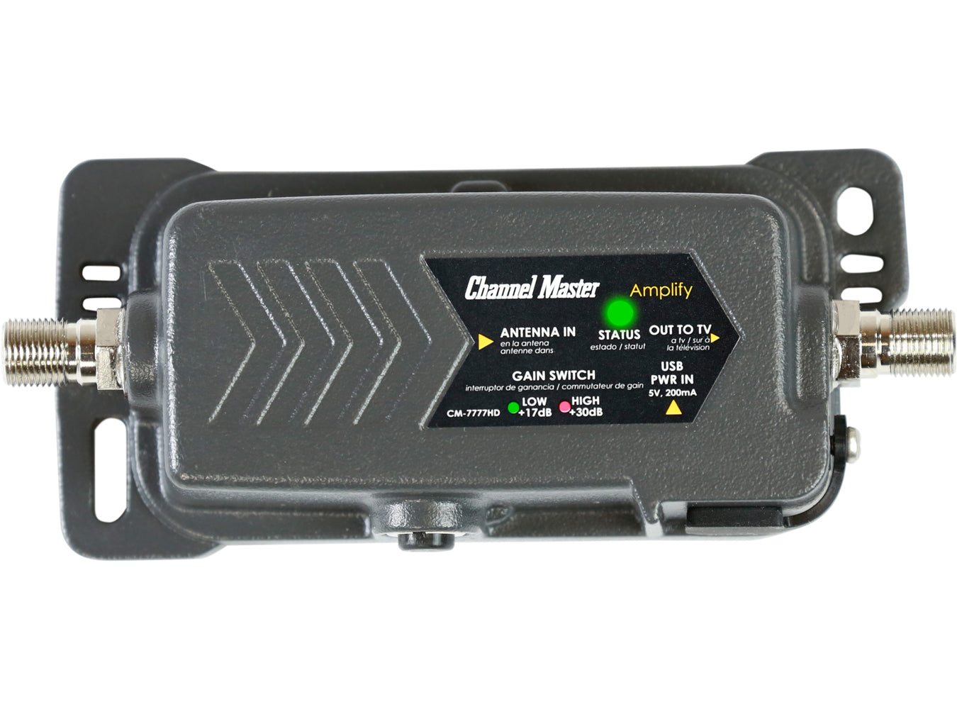

If you're 50 miles from the towers, you probably want to integrate a preamp.
This is what I use:

Preamps don't improve signal at the antenna. They improve signal if you have a long cable run and/or have splitters in the line.
"A mast or antenna-mounted preamplifier is used primarily to overcome the loss in the coaxial cable between the antenna and the TV."
I'll let others who are wiser than me chime in here, but I think that's somewhat incorrect. Long run, short run, without the preamp I can't receive half of my stations.

This guy explains it as well. An amp doesn't make the signal you get at the antenna stronger, it only boosts the signal for the run to your tv/splitter.
It a common misconception.

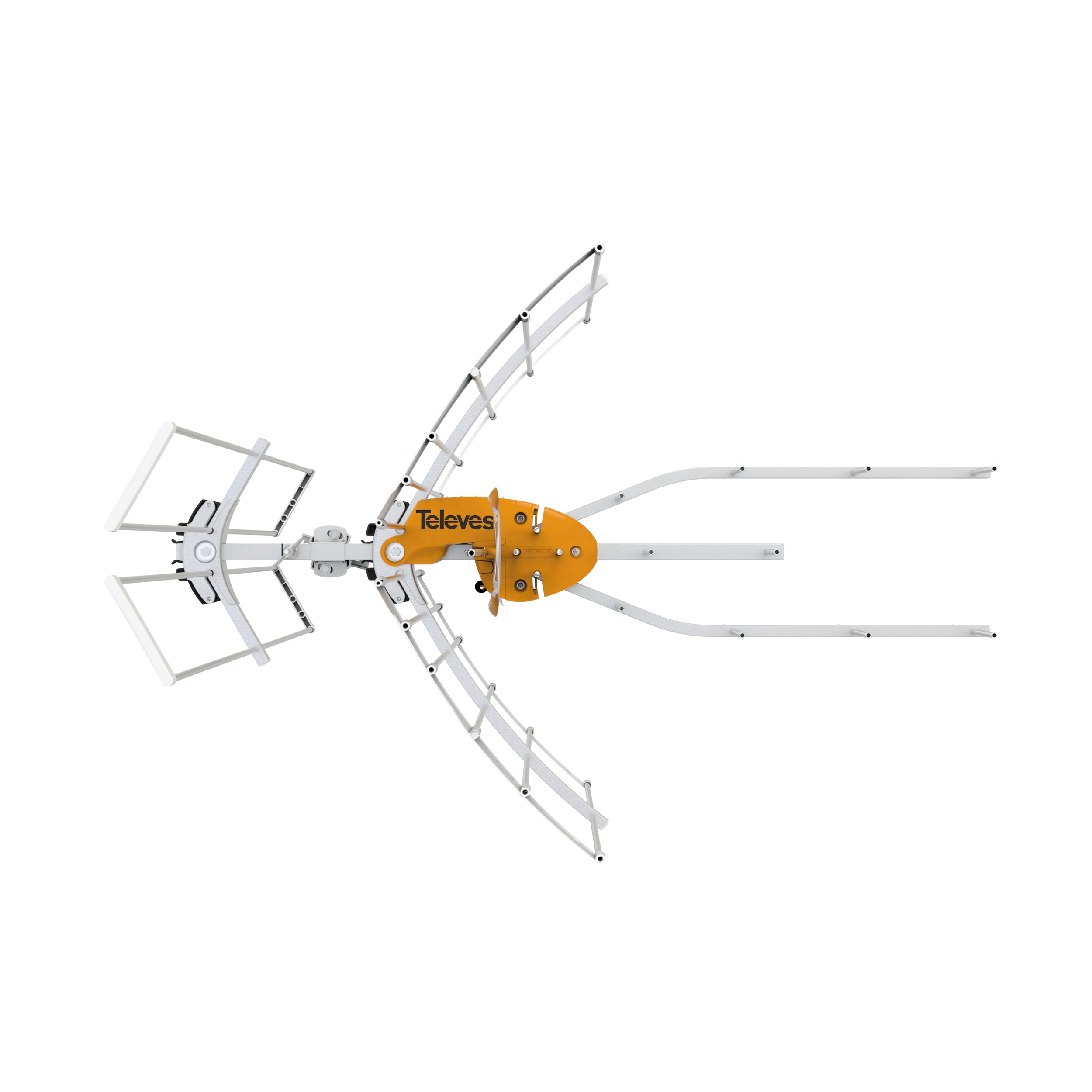

Get this antenna, (it's the latest model and version, completely re-engineered) and I'll bet your stations will all lock in nicely. I tested one, and it's the most powerful yet on the smaller side antenna I've ever seen. I had NO issues picking up stations at 50~ miles using it. It'll fit on the same pole you now have your 2V on. 5g/LTE and FM filters built into the dipole preamp.
Specs: Antena Ellipse Mix High-VHF/UHF (Repack Ready)
Installed at my sons house:

If it works for you, then ok. But telling people they need to buy a $90 amp is incorrect unless you have a long run and/or splitters. The people who do know more than you (and I) as well as the manufacturer agree.
I mean, here's another discussion which has multiple people saying this as well.

Agreed, the preamp does not create a signal that isn't there but if the signal is there but low it will help get it down the coax cable to your tv (or distribution amp in my case) in still usable condition. Our stations are in the 40 to 50 mile range away and two edge. No preamp at the mast means no signal at the house. ;)
I agree with this. I think he thought I was implying that the preamp tunes in signals that aren't there; I know it doesn't. But in my case the cable length doesn't matter; I'm 40+ miles from my towers and without the preamp I get almost no channels. That's whether it's rabbit ears connected directly to the TV, or the antenna in the attic.
