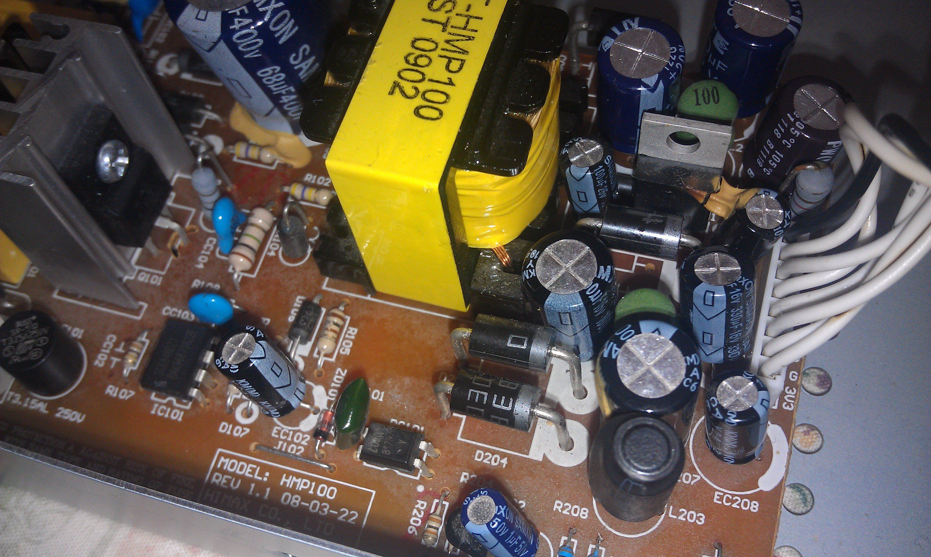

IMAG0664.jpgHello all. I do.apologize for flaming . I know there lots of members here with plenty of knowledge.and experience. Well, thanks to your help I was able to replace capacitors the right way this time, negative and positives sides how they should.be. caps are ok after receiver has been connected for well over an hour. Receiver powers up, goes on standby, channels, the whole nine, but still no signal or quality....again, any help is appreciated. I know I had posted that I might have damaged my rectifier in a previous post but being that receiver operates fine except for.signal and quality issues would that still be the case? Thanks again.
edit: added an image of the board i'm working with. the 3 caps i replaced are at top right hand corner .
