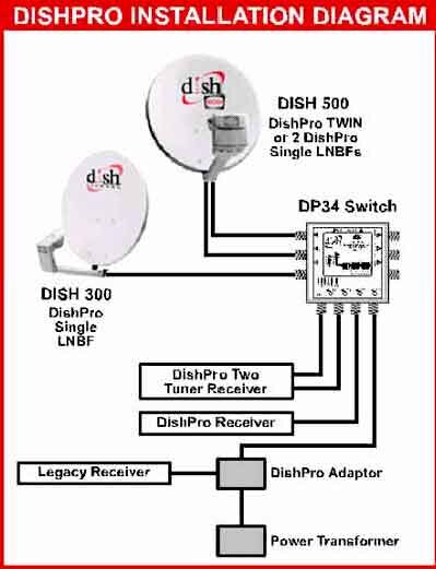

If you keep the DP34 switch, you need to run two lines
from DishNetwork's tech portal on how to hook up a DP34 to receivers...note the 2 lines to the dual tuner receiver ;)
