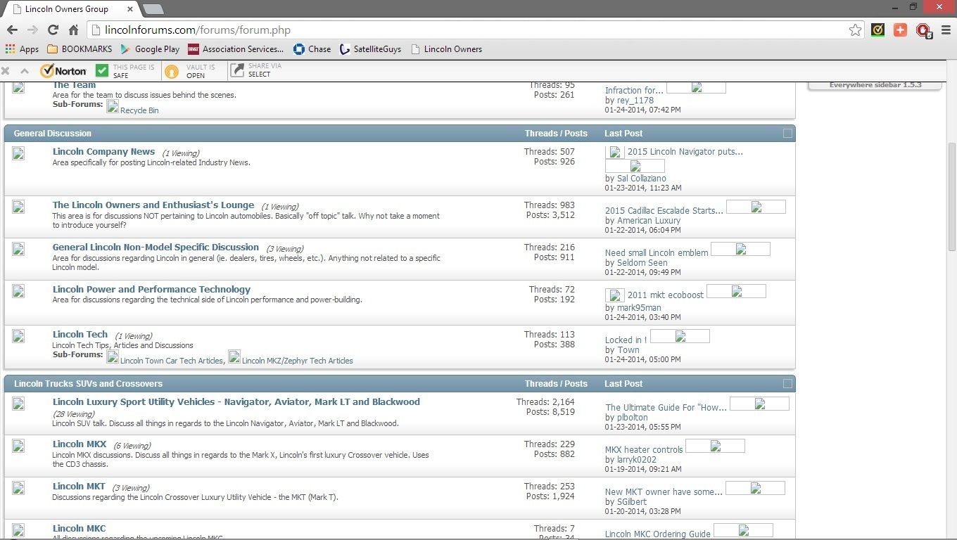

Been having this issue on a few sites where I'm seeing a lot of broken image links.This is happening with all my browsers on my Desktop at home, nowhere else. I've messed with Java and double checked other plugins,checked the host file,cleared all content on browsers,checked for spyware and viruses. Disabled the firewall to see if the problem is there but still see the broken images. I'm not sure what else to do and would hate to do a clean install here of Win8. Any ideas? Here's a picture of what I'm talking about.
When I bring up the java console I see a lot of "Failed to load resource: the server responded with a status of 404 (Not Found)"
The issue is on my end, not the websites.

Yep the laptop is wireless and the desktop is hardwired. When I checked the logs for the hardwired router I see the same error I found in the java console. /rootDesc.xml not found, responding ERROR 404
what is/was common between the links for the busted image(s)?
Right now I'm only seeing it on one site. The images are similar to what we have here on the left at the forums page where you see the read and unread forums. Also anything like links to social websites like facebook are showing up broken.
Well I got rid of the error at the router with a firmware upgrade but still have the issue on my pc. I thought the laptop was fine but it's not :o.In fact all my smartphones and tablet are doing the same thing. Maybe this will give you guys a better idea what the problem is. Maybe it's an issue with the ISP? If so then my hands are tied I guess.

If you right click the image, does it give you the option to open or view it, and if so what happens? Because it is happening on all your computers/devices it probably won't open. Sometimes when it is device specific, the image will open and it indicates a problem with Java or some other program interfering with it opening.

If it were an ISP to CDN problem, one would expect it to be resolved fairly quickly. The CDN probably carries a lot more traffic than just satelliteguys, so a bunch of other web sites would be broken and people would be complaining.
