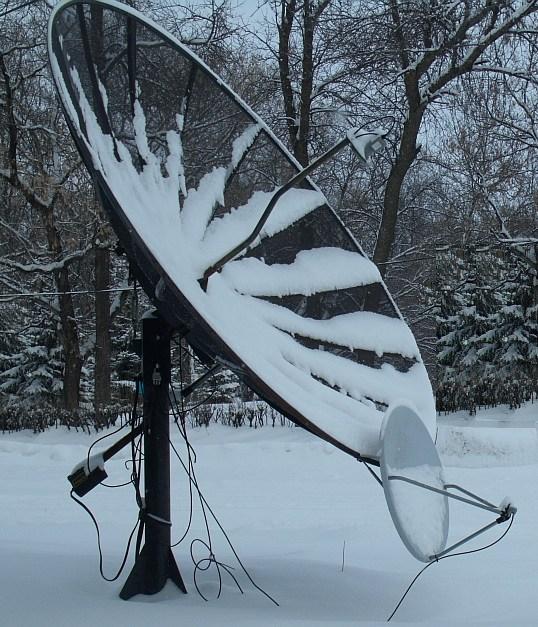

I mounted a 30 inch Channel Master to the lower lip of the BUD. Tracks the arc along with the BUD.
Out performs the BUD by a factor of 2+ on Ku (There's not much it misses) I do have a 1 meter but think the weight may be too much. ( I do have to admit - the mesh on the BUD isn't that good at Ku - too much airspace- Perforated would have been OK
All I can say is I've been pulling excellent C and Ku on my 7.5' KTI mesh for over 20 years using a low temp dual LNB Corotor system here in eastern PA.
Agreed on the corotor system, they do work pretty good. The Combo LNBF's is the ones that have the main issues. They are kinda hit and miss.
I agree, the only point I was trying to make is that the fault doesn't lay with the mesh dish. The feedhorn configuration is the major determinant. I probably should have been more clear. :)
Two other factors that may cause difficulty reliably receiving KU on large reflectors are surface accuracy and mechanical slop.
Reflector surface imperfections are more obvious with the higher KU-band frequencies and the often have lower efficiency on KU. 3-4GHz is much more forgiving.
With such a narrow beam width on KU, any slop in the mount, actuator or surface distortion / movement with wind loading can make KU-band aiming difficult. This shouldn't be an issue for well constructed and maintained dishes with tight tolerances.
True, but I think you could say that about any dish. A Wok with imperfections and/or slop in the motor gears can be just as detrimental to consistent quality reception. The whole trick is to have well maintained equipment, to have that equipment properly installed, and to have it properly aligned including tweaking the sweetspot. On a large dish a well constructed polar mount is essential. In 20 years I have aligned my dish just 2 times; once when I originally installed it, and once 10 years ago when I moved to a new house and took it with me (I didn't mind moving the dish but digging a new hole and hand mixing all that concrete again was a PITA). :)
