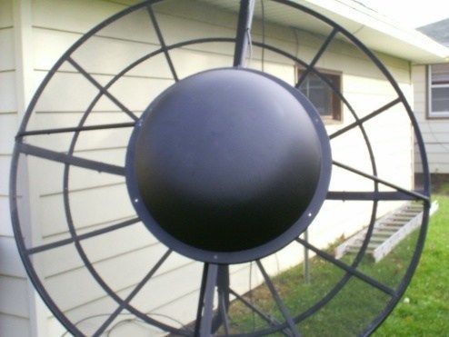

I used a plastic cover over my C-Band dish LNBF, the signal quality dropped about 5 points on the meter. Not a big issue with C-Band as rain is not really an issue, but dropping 5 points with KU signals can mean trouble in the rain. The water collects on the plastic and seems to fragment the KU signals.
With a C-Band dish the whole dish points at the satellite (prime focus), also concider paining the dish the same color as the background, or nearby follage.
Forgot to add many truckers often have domed satellite antennas (Some in motion with a TV on the dash!!!) on top of their cabs, the satellite signal comes right through the fiberglass wind break on the roof, again they can expect around a loss of around 5-10 points on the signal (DBS) meter as the signal has to go through the dome and the fiberglass.
