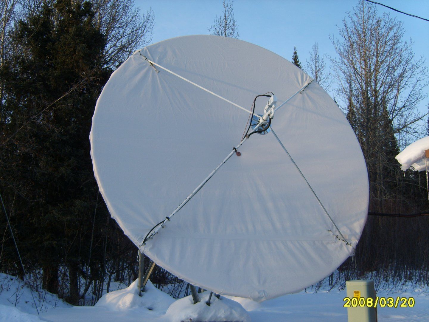

Most materials you would use will not block signals. However, talking from experience you are not likely to get anything to last long on the dish. Heating it is not practical, and when snow starts falling it will collapse any but the most robust covers. This is what our covers look like on a 4.5 meter dish, they probably weigh over 100 pounds. And our look angles are very low in Alaska, it will be worse where you are for snow weight, snow will not slide off like it does here they have to be taut like a drum.

i think if the cover used the arms to support it the snow would slide better?
For sure that would help, how much snow do you get and how often? What size dish? Can't hurt to try but I am not optimistic unless you get strictly dry, fluffy snow in very cold weather. Wet snow, a big problem.
those are the covers im looking for yes. i still thinking i may have problem with wild coming from back due to dish being mesh
