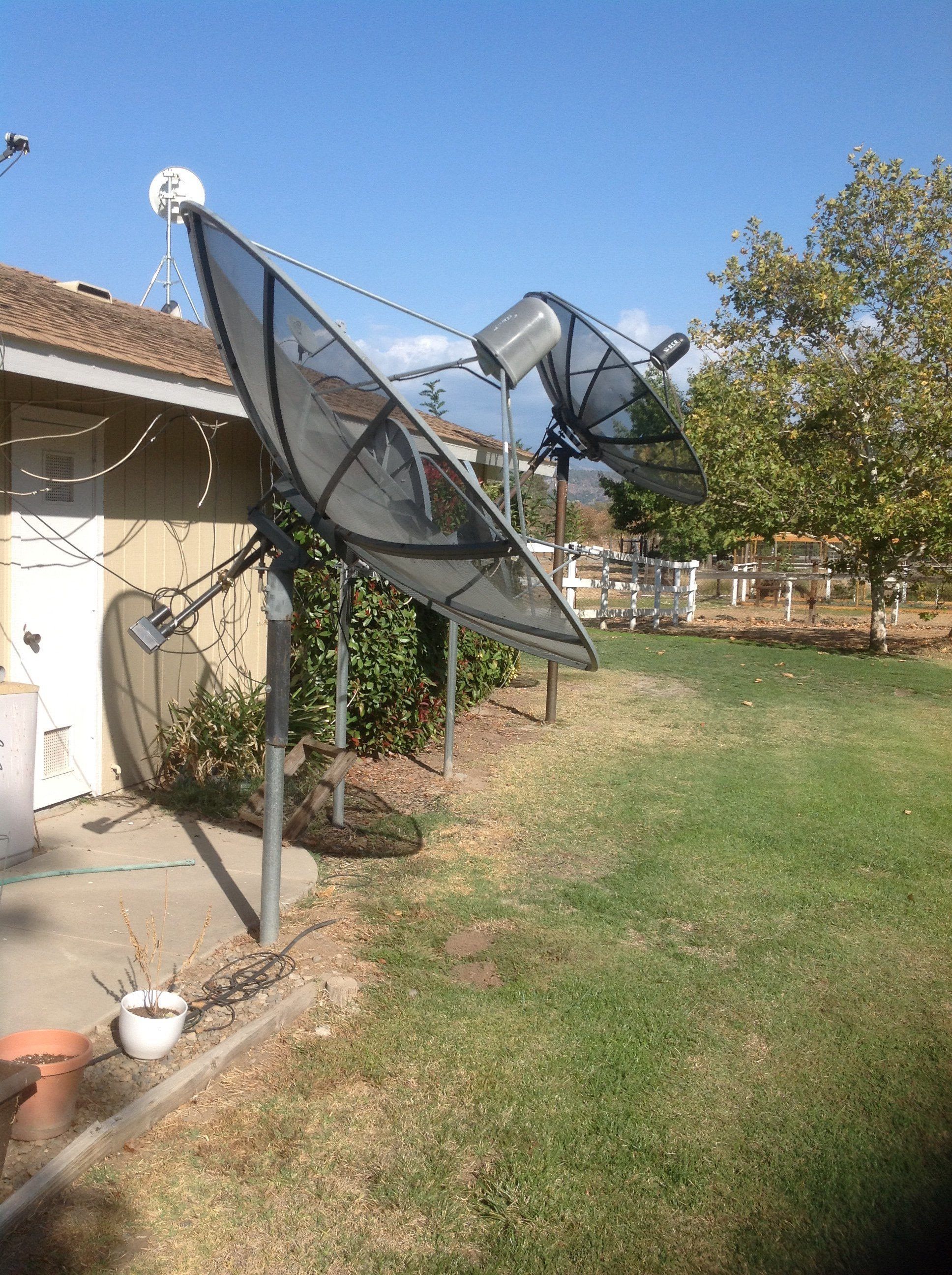

9 ft above ground vs. 5 ft above ground
Both C band dishes are 7.5 ft diameter. The one in the foreground is 5ft above ground and the one in the background is 9ft above ground. I ride my mower under the back one easily, however the one in front is a pain in the neck.. I think they are both pointed at 101W. I'm at 37N. Latitude so you see how they sit.
