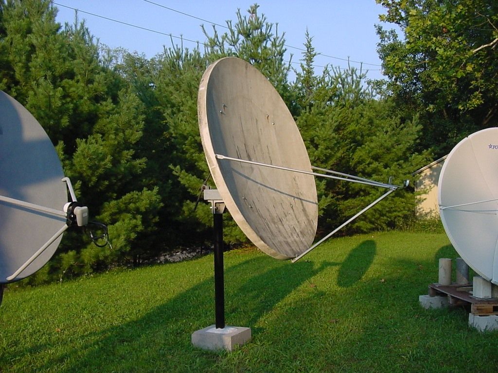

When I put up my last dish last year I used a 3.5" OD concrete filled post from Lowes. It was 8' and one piece without the jack screw. It came with 2 little square metal plates that are for it's intended support purpose. It was less than $50 and ridiculously heavy. I painted mine black.

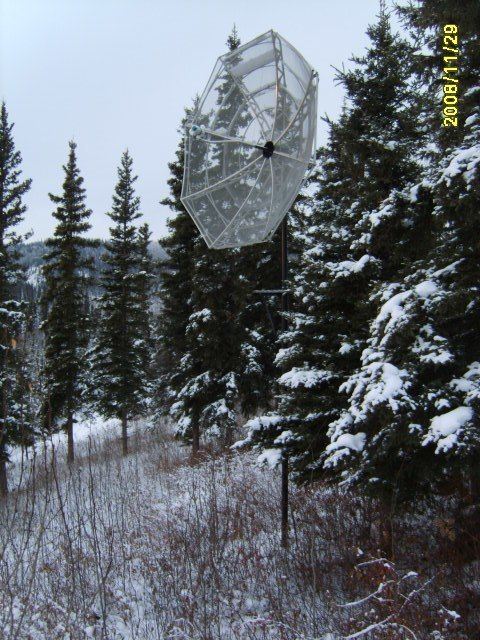

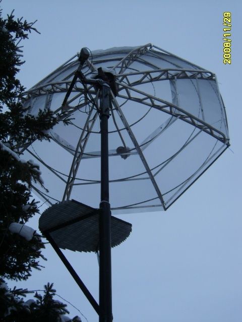

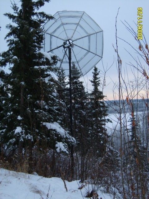

I installed countless 12 footers using 3" schedule 40 mild steel, never had a problem. We welded a piece of angle iron or rebar maybe 10" long about 6" from the bottom, running vertically and never ever had one twist. In Oregon, we dug a hole about 2' deep, made the hole wider at the bottom than the top and used about 3 bags of concrete. High wind areas or different soils may need a deeper hole or more concrete. Here are a couple pics of my current BUD, these have been posted on here before.
This one is different, FREE-STANDING, no guys, 12 footer. About one yard of concrete, 4" well casing tapering down to 3" (3 1/2 OD). Has been standing for 10 years now, it's up in the trees!

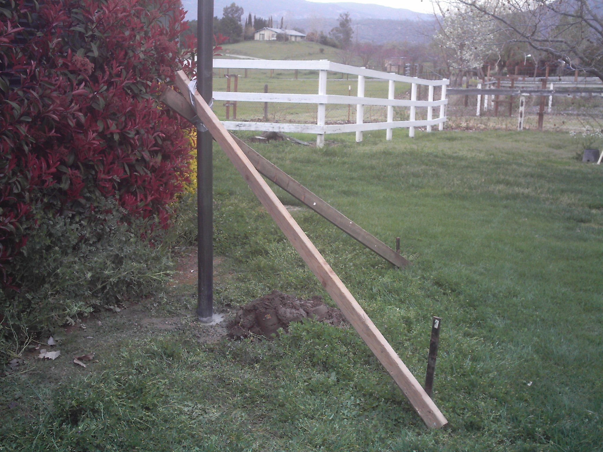

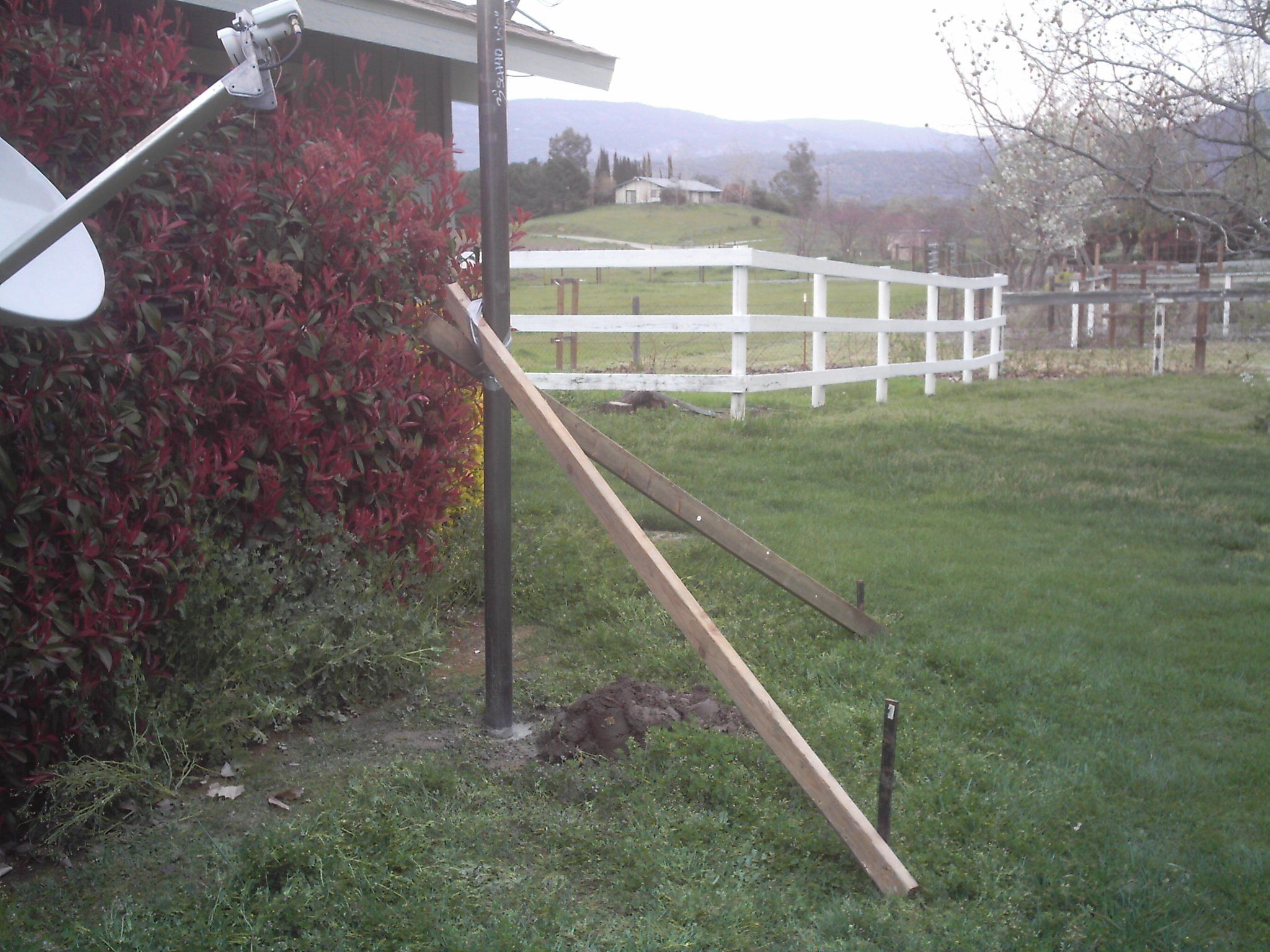

It is 3 1/2" OD and 3" ID by 10 1/2 ft long. I dug a 3ft hole with it wider at the bottom and placed 3 flat old small concrete chunks in the bottom to support the bottom of my pipe. I use two 2x4's at right angles to each other with two small magnetic torpedo levels to ensure it is perfectly vertical. At the end of the 2x4 I use one standard concrete form stake nailed to the 2x4 and driven into the ground. On the pipe I only use DUCT tape to hold it steady. One ft from the bottom of the pipe I had a friend weld a small steel flat bar about 10" long to keep it from twisting later. The top of the pipe is now 7 1/2 ft above the ground.
I used 3 bags of concrete and it is solid as a rock. It has rained here almost every day since, and I have water coming from every where above me, so I have since removed the 2x4's, but it is too wet to even mow the lawn yet.

The only change I would have suggested to what you already did, was to "mound up/round the top" of the concrete slightly above ground. That way, you keep rain water from pooling right there, and soaking and continually softening the ground immediately right around the cement.
It's all work well worth doing, and doing a bit of over-kill. You'd be amazed just how much of a wind load even a 5 foot dish can support, and still twist, bend over, or torque the pole.
