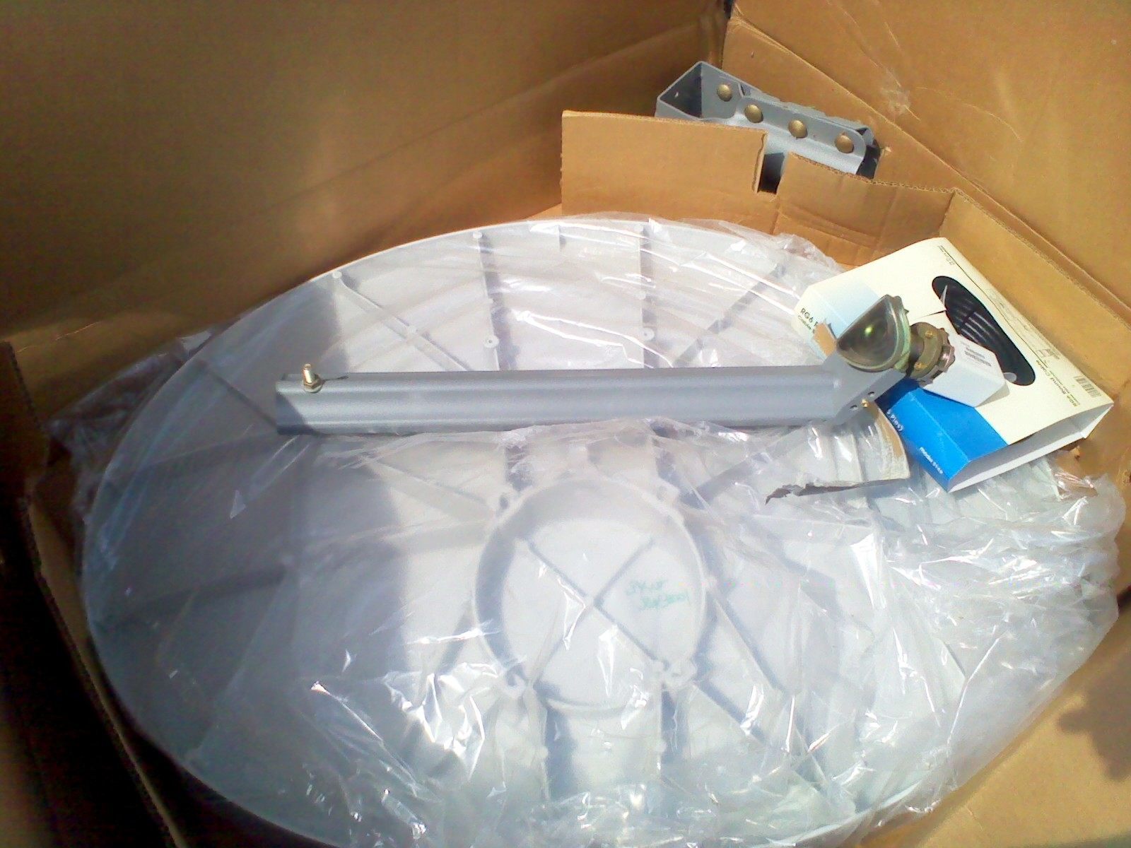

Came home to a DTN dish (newer style) on my porch! What should I use it for?
radio
"On the Air" in MI
Oct 13, 2007
3,739
916
West Central Michigan
Given I have (2) of the older DTN's deployed (Channel Masters as you know) for PBS and for NBC Ku feeds,
Would this dish and it's included NORSAT LNB be any better for weak signals on a single polarity than our consumer ones?
Should I deploy it fixed for better PBS signals?
Motorize it for scanning? (I don't do that much, my birdview does the Ku and C scanning)..
I guess what I'm asking is how should this dish perform compared to the smaller round Channel Master ones, and would you change the LNB
for a new one, or use it on a fixed polarity as is?
I've not worked with the single-arm DTN dishes, always the round 3-arm support ones by Channel Master.
A friend of mine's Dad was sent this to upgrade, then they apparently kept the old dish in place when DTN installed in his second location. I like Santa bringing dishes in April!
Fun project to come...no matter how it gets deployed.

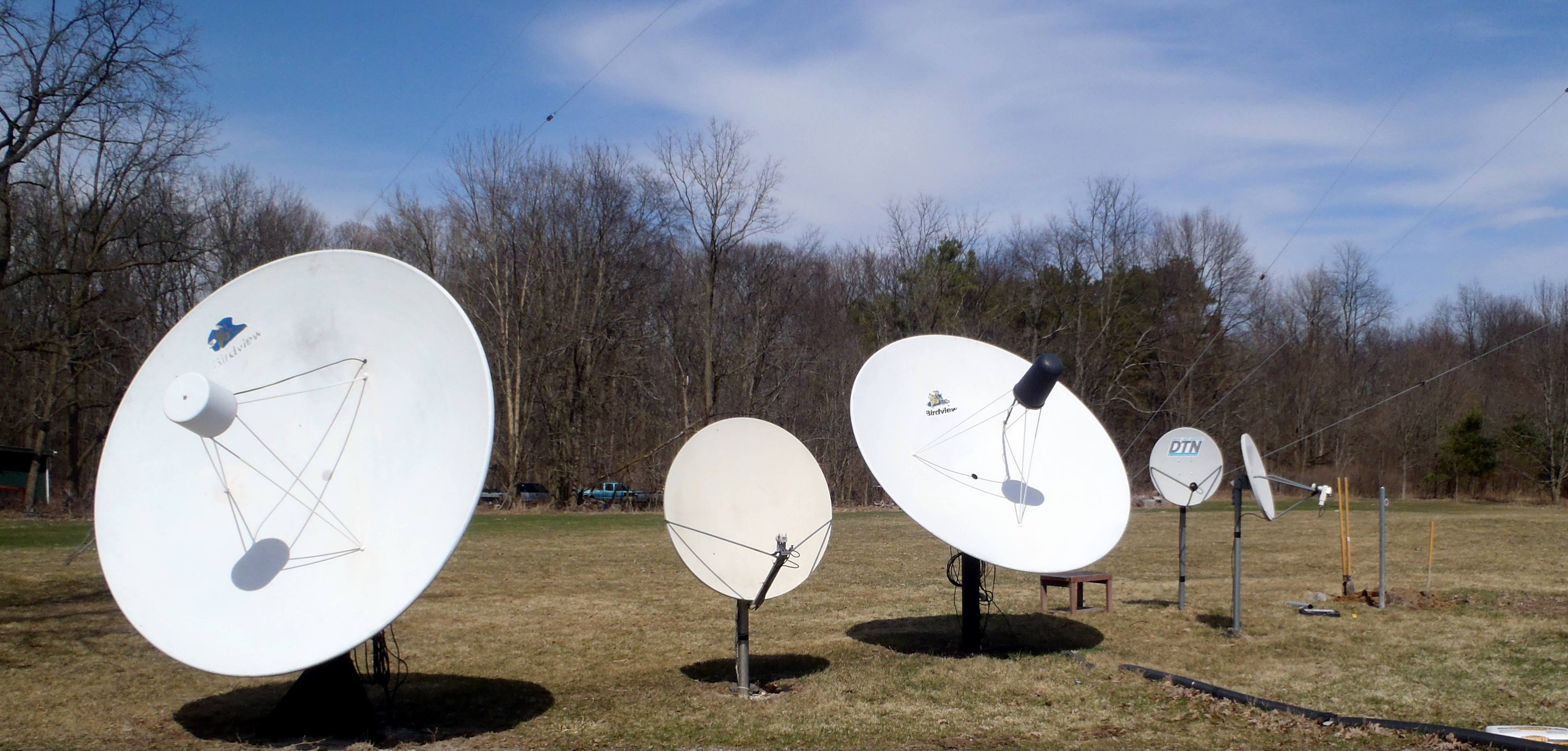

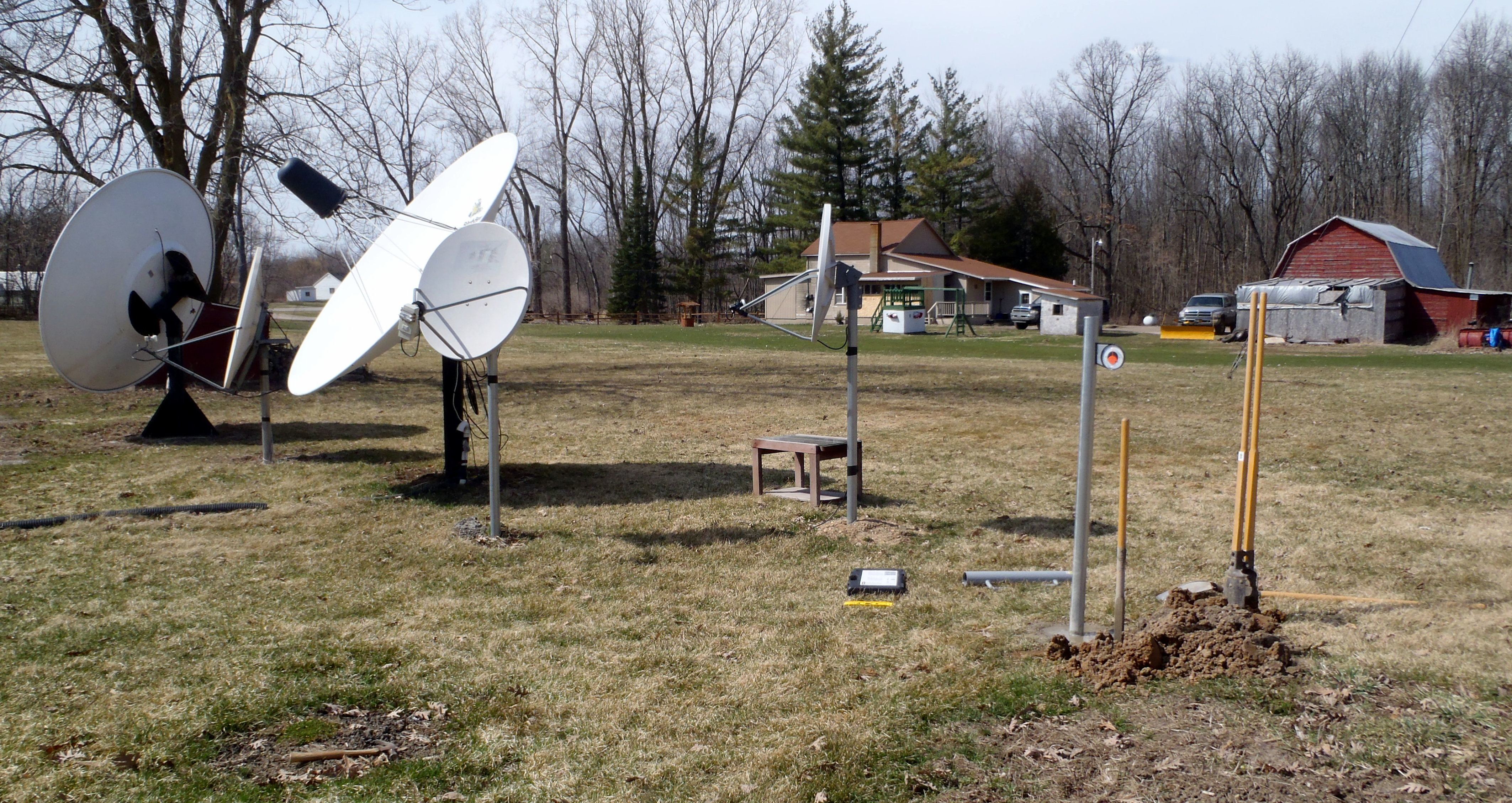

Preparations begin for the DTN to go in! We finally got GREAT weather. It won't last, but the dish will be ready to go
on the new post....for whatever it gets used-for. Maybe just music feeds...
My buddy that says he won't plow my drive if I add any more...is not plowing any more. So, no worries.

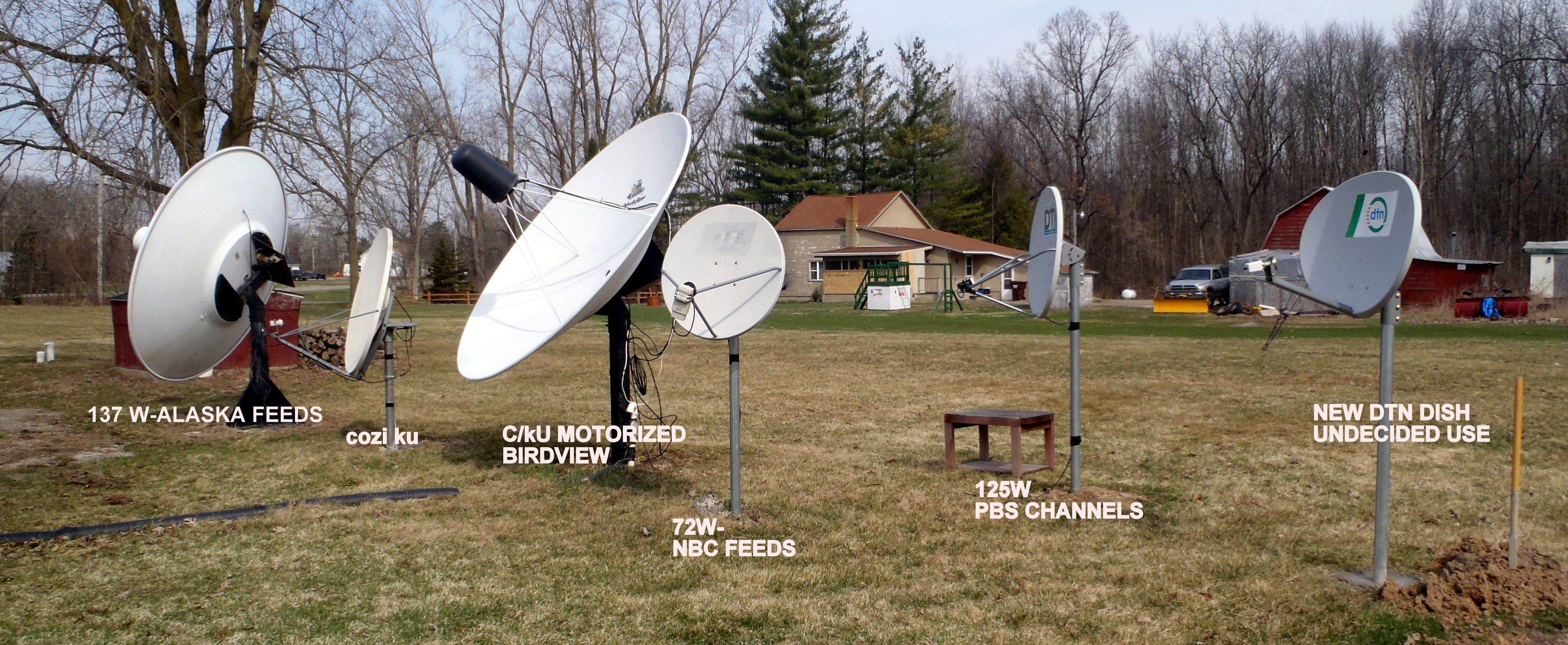

Well, the dish is "on" the pole now....
Looks like fun to perhaps compare this dish and it's supplied original Feed to the DTN "round" version on PBS and see which does 125 better....
Especially since if I read the "list" correctly, most of the PBS I'd normally use is vertical polarity, and the dish is set for that to begin with.
That MAY be the first use of this dish, though I'd like to find an exact bolt-on replacement for this LNB that covers both polarities. I think
there are some threads with this here...and will be searching.
With COZI being so finicky lately, I may re-aim the Cozi dish for PBS, freeing up the current round CM/DTN dish AND this one for other Ku...have not decided yet, but the install is fun!

does the new dish skew as a whole or does just the LNB skew?
I know the Shaw Direct dishes (which are CM dishes too) the whole dish assembly can skew.
yes most of the PBS stuff is vertical polarity
Very nice setup by the way
RT-yes, the wires go to our towers for WION-AM and our FM translator!
Ice: Yes, the whole dish can skew! I wasn't expecting that setup! I'm thinking I can leave the LNB "as assembled" and just skew the whole thing?
Thanks for the kind words on the setup! I think it'll grow a bit this year, and I'm finding that I really "don't" need motorized Ku, as most of my Ku
can be confined to just a few dishes and switches, and there's plenty of room! I've learned much here on this site. I'd LOVE to switch to an 8-place diseqc vs.
a 22khz switch feeding 2 other diseqcs, it may speed up the switching between dishes...not sure.
