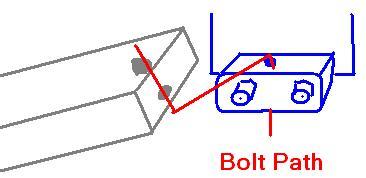

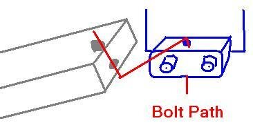

I haven't personally modified a Slimline yet, but there are a couple of members here who have (using the conduit clamp method), with good results.
I would make note of where the faces of the original feedhorns sit, and make sure that the clamped linear LNBF can be adjusted to be within that range.
I took off the LNB assembly, bent a piece of aluminum flashing to cap the end of the arm, no cutting, then drilled through the end to allow me to bolt on a 10750 lo circular for the free stuff on 118 a little while ago. The lnb sat 3/4" deeper than the original focus. With only 58% quality, it needs adjusting. It was super simple though.
