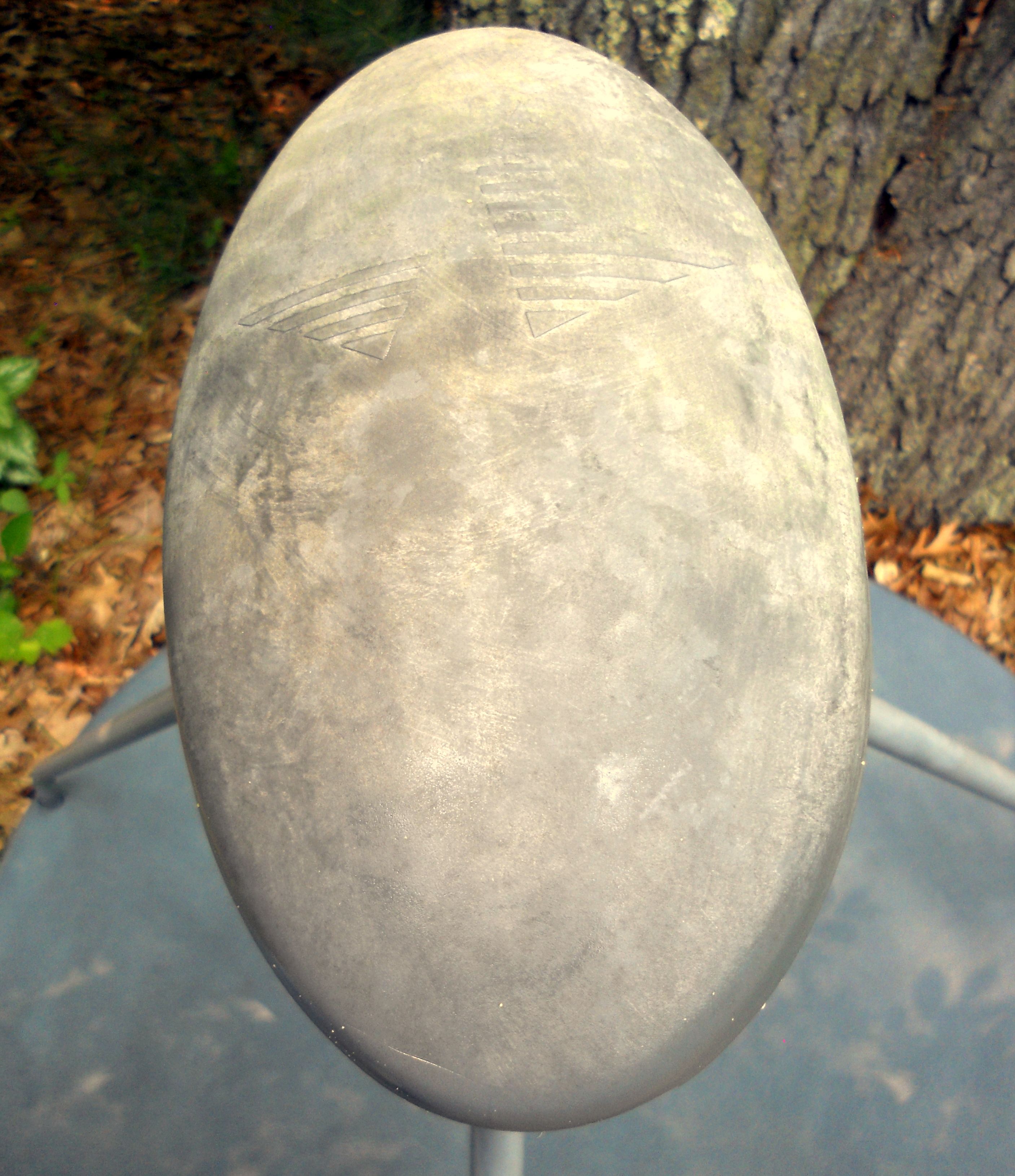

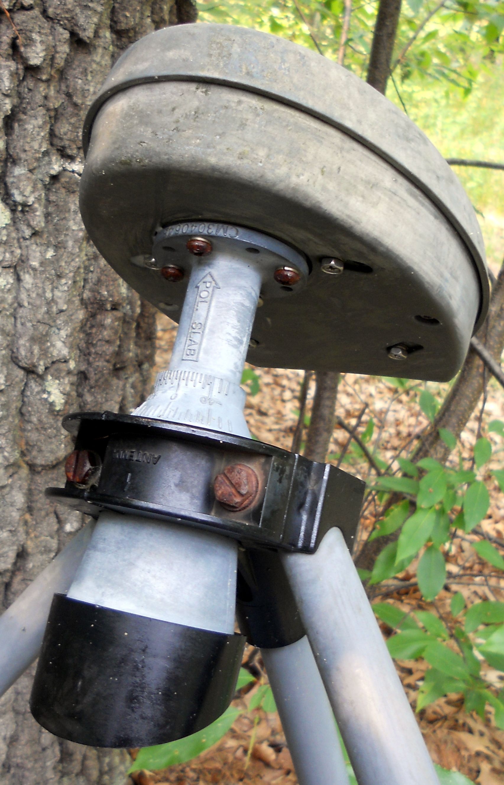

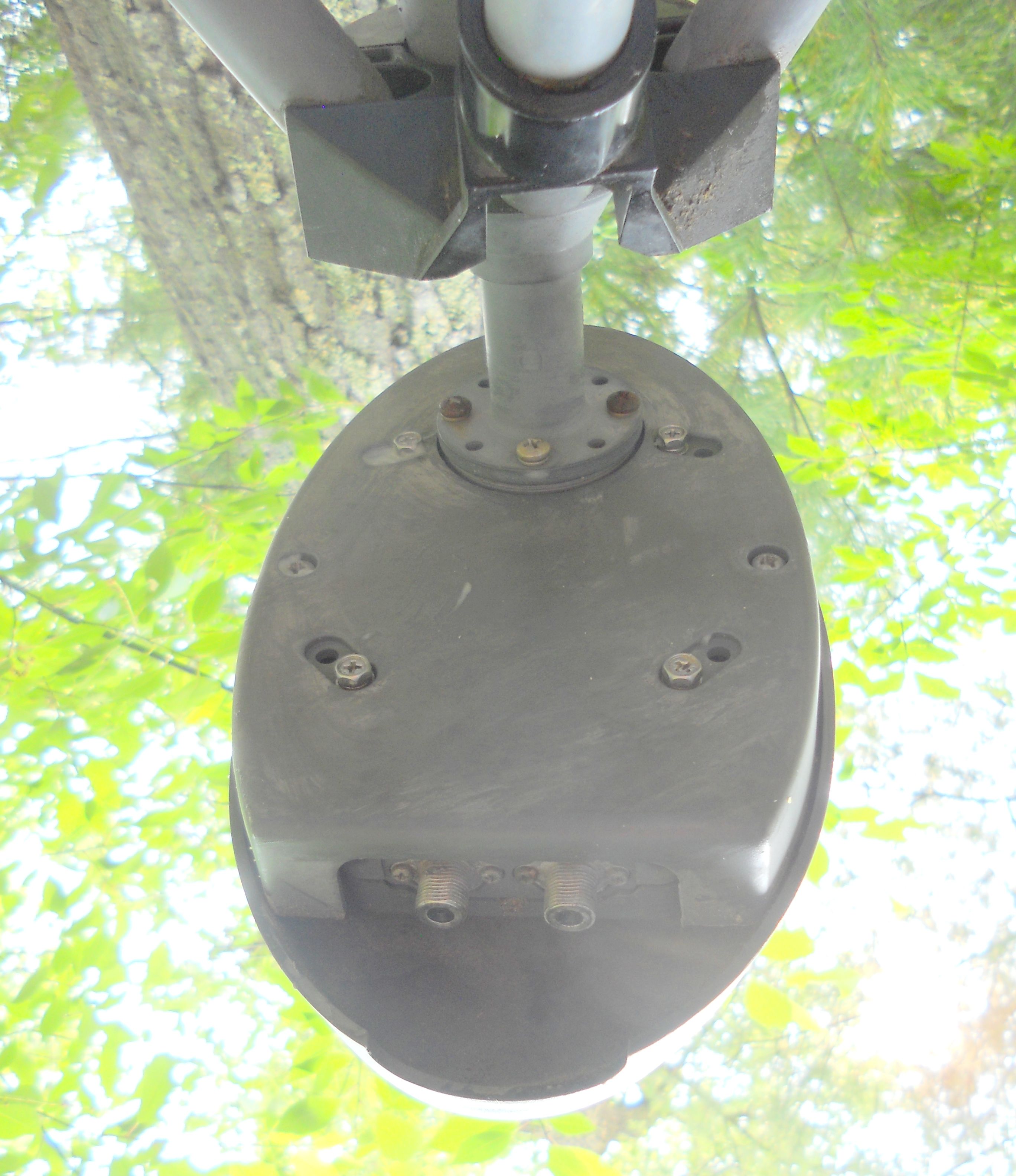

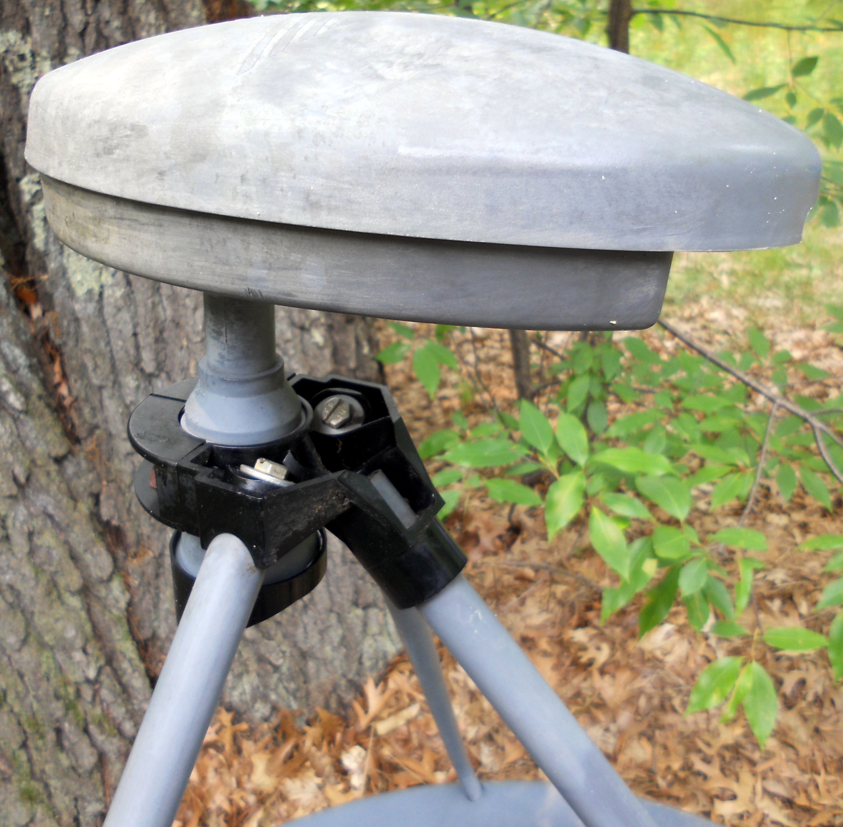

Can anyone tell me what this LNB is?
ancient
May 12, 2014
441
229
USA
Saw an old Ku dish next to an apparently unoccupied house so I left a note on the door. A month later got a call from the owner saying I could come and get it. :biggrin The dish is a 1.2 meter Winegard and it has this LNB on it. Mainly I'd like to know if it's a decent LNB, or would I be better off replacing it with a new dual LNB? And also, is it really a true dual output LNB, or is it one of those where the H polarity is on one output and the V polarity on the other?

That's a Primestar lnb, circa 1997~. Looks like you lucked out, and it's the one with BOTH Horizontal and Vertical! Yes, separate outputs for H and V, but you can combine them with a switch. 10750 Low.
Not too bad of an lnb, noise figure around .8 I think, which seems kind of high, but they are very stable lnbs. It's at least worth testing to see if it'll work out for you.
