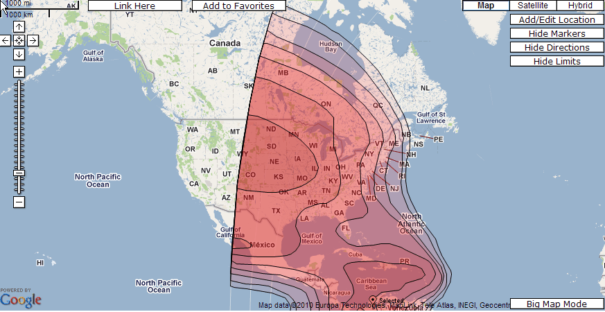

gorgojos,
You have a LOS, but the signal strength (EIRP) might be too weak for your dish size.
The strongest EIRP areas for the North American Ku beam from the Hispasat sats (1C and 1D both at 30.0°W) are ALL of SD, IA, NE, CO, KS and MO. Most of ND and IL. SW MN, N OK, E WY and E MT.
Attached image is the footprint map for 30.0°W from SatBeams.com You can go directly to their site to determine the actual signal level expected if you are in any part of the valid footprint and thus determine the recommended dish size.

This is the recommended dish size in cm from Hispasat website. http://www.hispasat.com/media//Instaladores/America-30.jpg
It says 75 cm for MA and surrounding states. At least for the 5 strong TP's (Russian TV1 no longer avail but TP signal is still there) a 90 cm dish should be good. Maybe the "gorgojos" on your dish are killing the signal , lol.
For aiming try the new 11972H 27500 FEC 5/6 , it is the strongest TP for me nowadays. Remember to skew the LNB accordingly.
