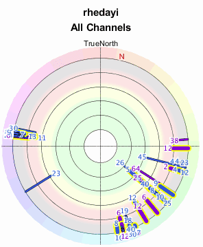

Can i get some major networks - TVfools info supplied

It probably isn't reasonable to ignore that they are all two-edge obstructed. My point is that one broadband antenna may be sufficient and almost certainly cheaper than two or three narrow band antennas.
Looking at the directions though, it may be useful to notch the VHF antenna in with a joiner as Iceberg suggests as one big fringe broadband antenna probably isn't going to grab the stations to the west while pointing southeast. Again, it comes down to what major networks are important.
If a rotator is being considered, a broadband antenna would be the only logical choice.
Right... I'm not disagreeing the signals are weak, but they're all he has if he wants all the major networks. Keeping his smaller combo pointed in one direction, and pointing the VHF only in the opposite direction at least gives him a fighting chance. I find it hard to believe that it won't pick up something if assembled & aimed correctly. Practically every distant station I receive is 2Edge, and I'm in the south with mountains and hills to deal with. 2Edge is iffy, but isn't impossible like some believe.

Numbers do not lie. They were never very good for Los Angeles stations, and you have issues with levels from both Mt Wilson to the west as well as the mostly UHF transmitters east of you. These numbers also assume a clear line of sight path, and what many people do not appreciate is simply how tall the mountains are in the Los Angeles area. Your line of sight is
much worse than the numbers because of your local obstructions such as the neighbor's house. The only reason that San Diego area stations are working is that you have a partial water path and nothing major in the way.
