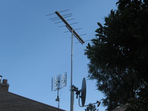

Yagi Above OTA and FTA Antennas.jpegThanks Guys! I made a Yagi to get WNGS (WBBZ) Buffalo and it's working pretty well. Two Yankees games this week!
I'm glad to see you were able to receive WBBZ. What part of Toronto are you in? How is your reception with your newly built antenna? Consistant good signal or sporatic reception? I am in the process of making a 10 element CH10 antenna to get WHEC Rochester NY, as they are adding MeTV latter this month. I do not have a hope of receiving WBBZ unless they increase their power. Do you have any closer pictures showing the detail of your construction?
Larry
My reception is not 100%. I lose signal around sunset for instance. I was able to watch the baseball game last night from about 8:30 onward. Signal seems strongest in the middle of the night and middle of the day. Nonetheless, I am pleased.
My location is quite good as I am on the top of the bluffs in Scarborough at Birchmount and Danforth.
Sorry I don't have any other pictures. To make it I used an old deep-fringe antenna from the cottage. I used the Yagi designer in this thread. The wood is an eight foot piece of birch from Home Depot. I put 3/16 inch radius grooves in it using a router to hold the elements. I got my balun and joiner at Sal's. Make sure you use good quality hardware!
