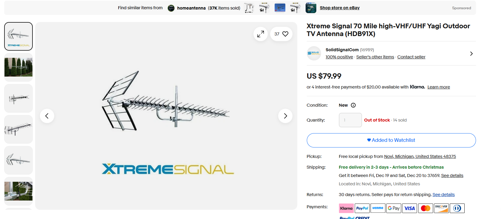

Anybody have any experience with these antennas? Look like super high gain on UHF, would be narrow beamwidth: Xtreme Signal 70 Mile high-VHF/UHF Yagi Outdoor TV Antenna (HDB91X) | eBay
Yeah, I used them for years, until I replaced them with Televes 149884's. Which have built in preamps that also filter FM and 5g, AND are high VHF & UHF.
The HDB91x's have very high gain, are UHF only, BUT it's highest up around channel 50, which is no longer there. They are ok, but they are passive, so ok IF you don't need a preamp, or care about FM radio or 5G intrusion above channel 36.
