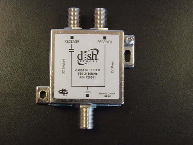

DishStore.net has a DP Splitter that might work. This is for Dish Pro LNBs. Here is the info:
Dishpro Approved Splitter $7.00
Please note this product will NOT split a DISH Network signal coming from a Dishpro Twin, Dish Pro Quad LNBF, or DP34 and allow you to hook up a duel tuner receiver such as a 522, 721 and 921 with 1 cable from the Dish.
The Dishpro Approved splitter is to be used for Specialty Applications such as cascading (2) Sw64 Switches, or for splitting the feed of a DP Single LNBF to allow you to run into (2) DP21 Switches so you can have 2 receivers looking at 3 orbital positions.
If your not sure about your paticular application, please feel free to call or E-mail us before you make a purchase.

DishStore.net does have a splitter that might work. It is for Dish Pro lnbs. Here is the info:
mm1, The mattyro does not have dishpro, he is using legacy "VOOM" dish. Legacy cannot ever be split.
