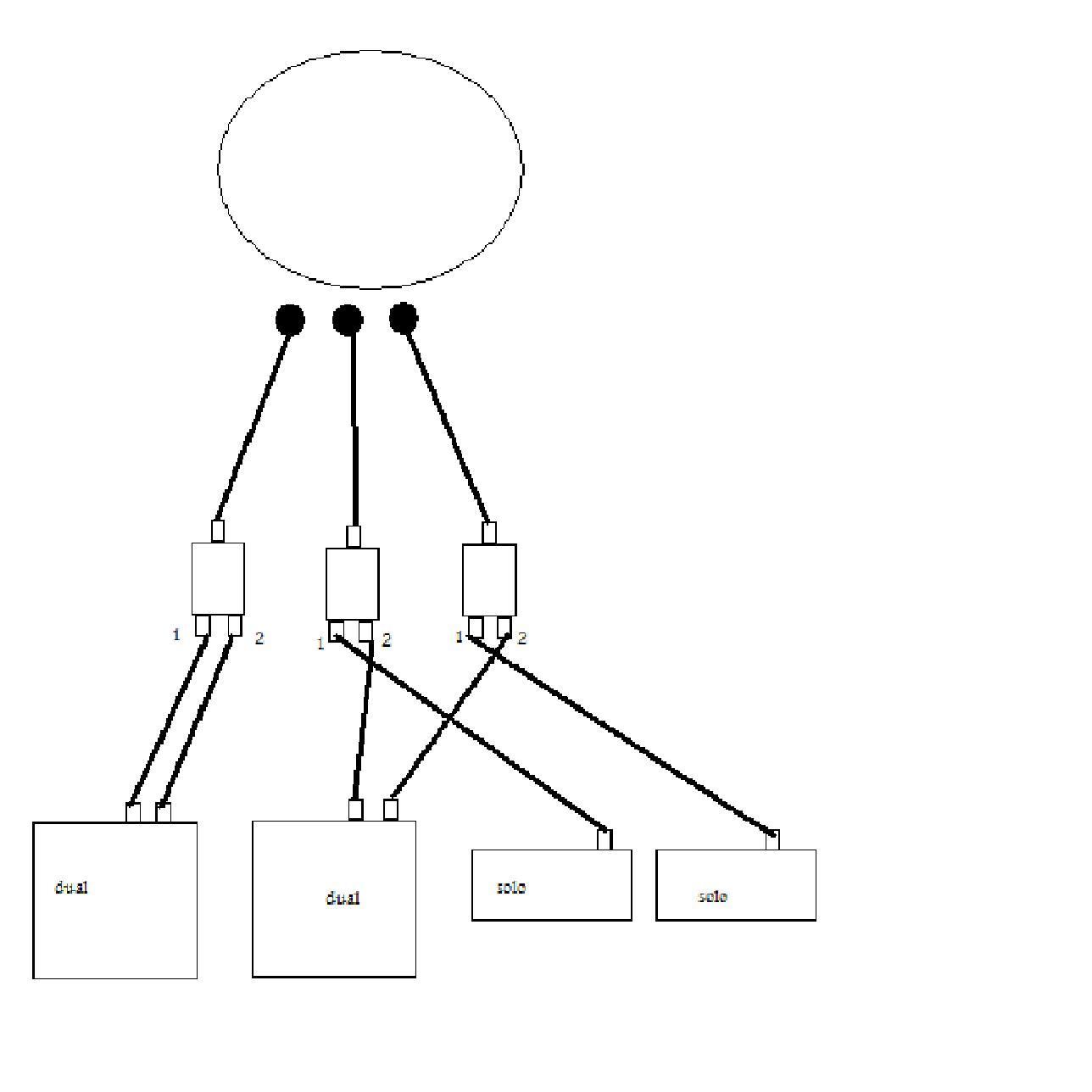

Oh okay, I see. I think I will still try my luck w/ what I have, if I run into problems I guess I'll fork out the cash for a switch. I still don't completely understand how you explained this setup. Just for clarification, I have two Duos, and two solos. Would I then need 3 duplexer (separators)?
Something like this?

That would probably work. But here is a little simpler way. I would also like to apologize if I wasn't clear enough.

Yes, that would be easier, thank you so much. I sometimes don't understand things if I don't see them, so this helps a lot! Also, I have triplexer... what can that be used for? I know obviously the two tuners, but what would be the point in having a 3rd port on it?
