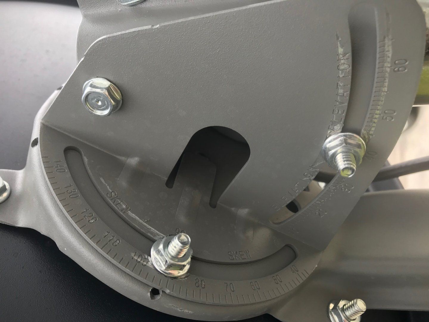

Can you post a photo of your dish mount that shows the elevation and skew settings you're using?
Ok, your settings look good for Liberty Lake. What satellite finder are you using and where is it connected? If you're seeing a 60-70 signal at the dish, then it may be that you have a bad coax connection at one end or the other if you're aimed at the correct sats. Have you run a switch test with the new setup?

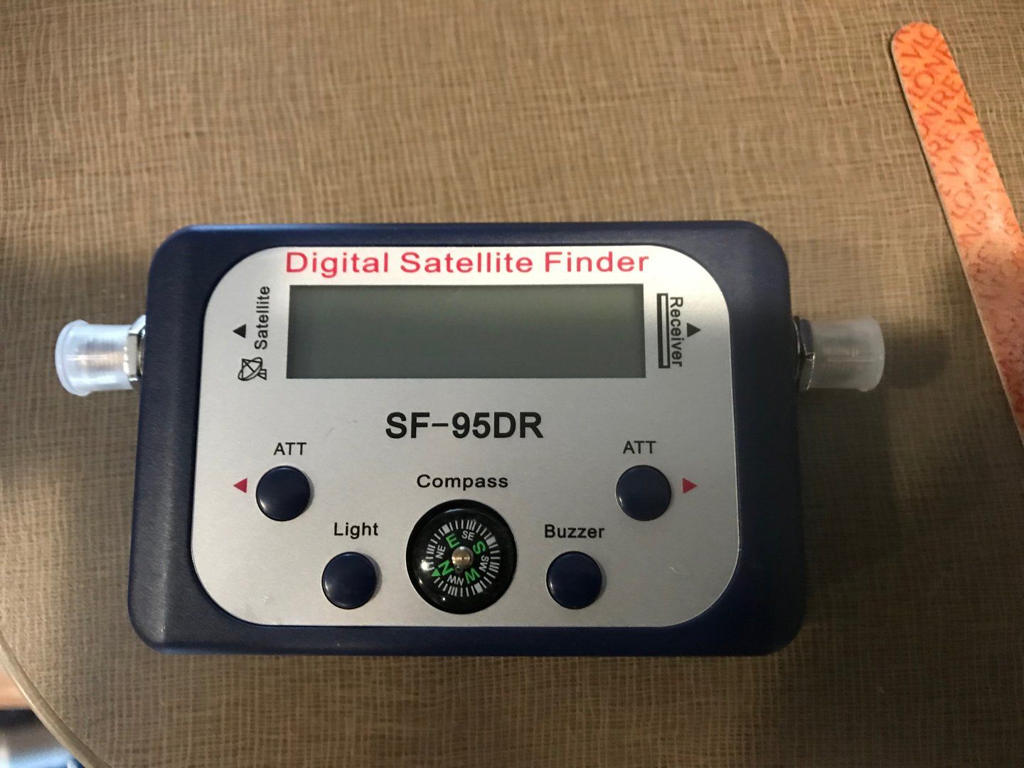

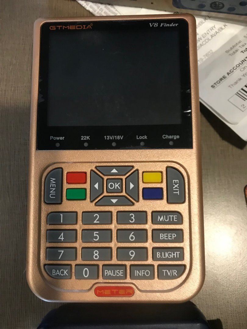

The two sat finders I have been using are:

It seems as though your aiming is 1 satellite slot (9-10 degrees) to far to the west. Swing your dish back to the left until you lose, then reacquire a signal using your analog meter. Peak that signal and run another check switch. Don't be concerned about which tuner is selected.
