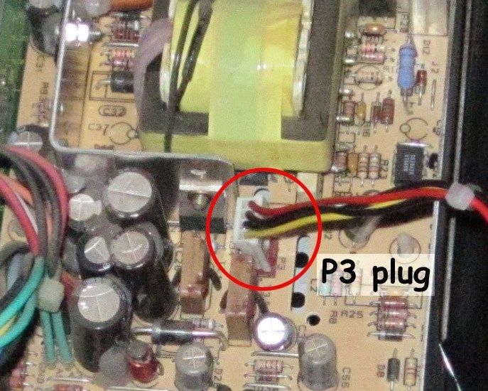

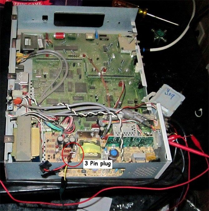

ok, I just got my new lnbf but in the mean time i got the thing going. I found a p3 plug that had 5.7 volts on pin 1 (first pin from the front). I took a three and a half inch floppy drive plug from old power supply and slipped it over the pins coming off the circuit board. Took pin 1 and ran it to the 5 volt wire going to the polaroter and it seems to be working.
I tried the 5 volt going to the actuator but it must not have enough current to run the rotor as it dropped the voltage to about 2.73 volts. Not sure if i will put in the new lnbf or just use it like it is.
