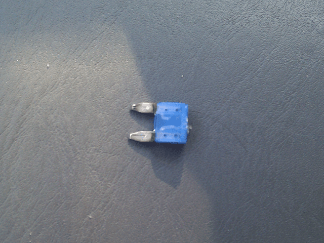

Problem solved. Finally figured out what fuse it was and sure enough it was busted. Replaced it with a spare and now both ports work just fine again. Biggest pain was getting the damn fuse out. Had to use special clamping scissors from my wifes workplace.
Here is the guilty fuse
