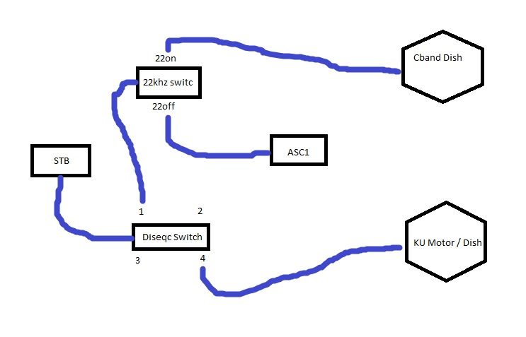

Its a fairly straight forward situation locking in 87 being its pretty much top of arc for me. I could run from 55.5 to 135 and get stuff on everything, but on 87, specifically the LUKEN mux on 4000H29125 i get a strong signal, but pixelation. I thought it was from lack of fine tuning. But, i got even a stronger signal today after fine tuning , and it is still doing it. At first, i took out the 22khz switch, it was still doing it, then i bypassed the ASC, and then the LUKEN mux came in clear. I re-plugged in the 22khz switch and signal still great. I need the 22khz switch for my C/KU setup.
That is the only transponder that i am getting pixelation on with the ASC1 in the loop. If i put the ASC1 back into the system, but put it on a 22khz switch so the LNB does not run through it, then the LUKEN transponder comes in fine. So, it is something on the ASC1 that is causing the issue. (of course, with this setup, i don't have my KU plugged in.)
Okay, this setup gets rid of the problem of the LUKEN mux on 87 and allows me to get my KU plugged back in, and my KU doesn't seem to be bouncing around when i choose a Cband satellite. Hopefully this will be the final setup.
I also noticed that when i used the ASC1 and started scrolling down to the SAVE position it would cause a momentary signal disruption on the channel. This setup negates that as well.
PS. the 22khz switch is an Ecoda which sends the diseqc signals down both ports always no matter the switch setting - allowing for this setup.
