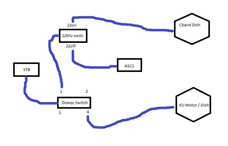

Okay - Port 4 seems to stop the motor constantly moving. Time will tell on that. This appears to be the setup that works.
You ought to replace that 22khz switch with a splitter or go through the ASC1 to the C-Band dish. A 22khz switch is designed to switch between LNBs.
Hey, I'm not gonna mess with working A-OK! The Ecoda is known to pass power and diseqc commands. Everything is working perfectly --- except --- I cannot seem to get fine tuned enough to pull in 137.
