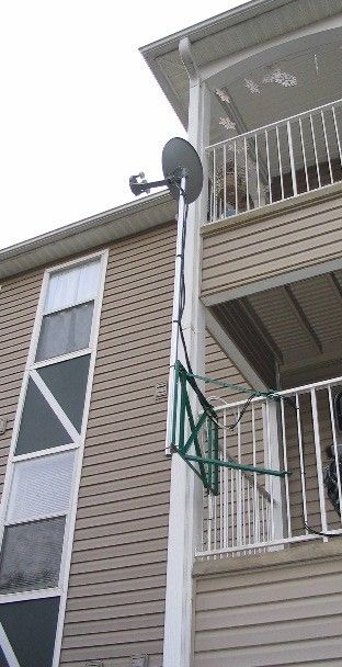

Here's one that I finished, today.
The entire mounting, including the dish was aligned and set up from the balcony.
The signal meter pegs at 101 and 119, with a decent 110 signal.

i don't suppose you were able to ground this thing to NEC...
In this area, almost all complexes prohibit this type of install..
Very imaginative job though..kudos
NEC is a real challenge with apartments and condos.
I grounded the system to an outdoor outlet by using a hospital grade plug with a 10 gauge copper wire to the grounding contact. Then, filled the plug with silicone sealant to prevent any kit from getting shocked by the hot contact.
It's better than nothing.

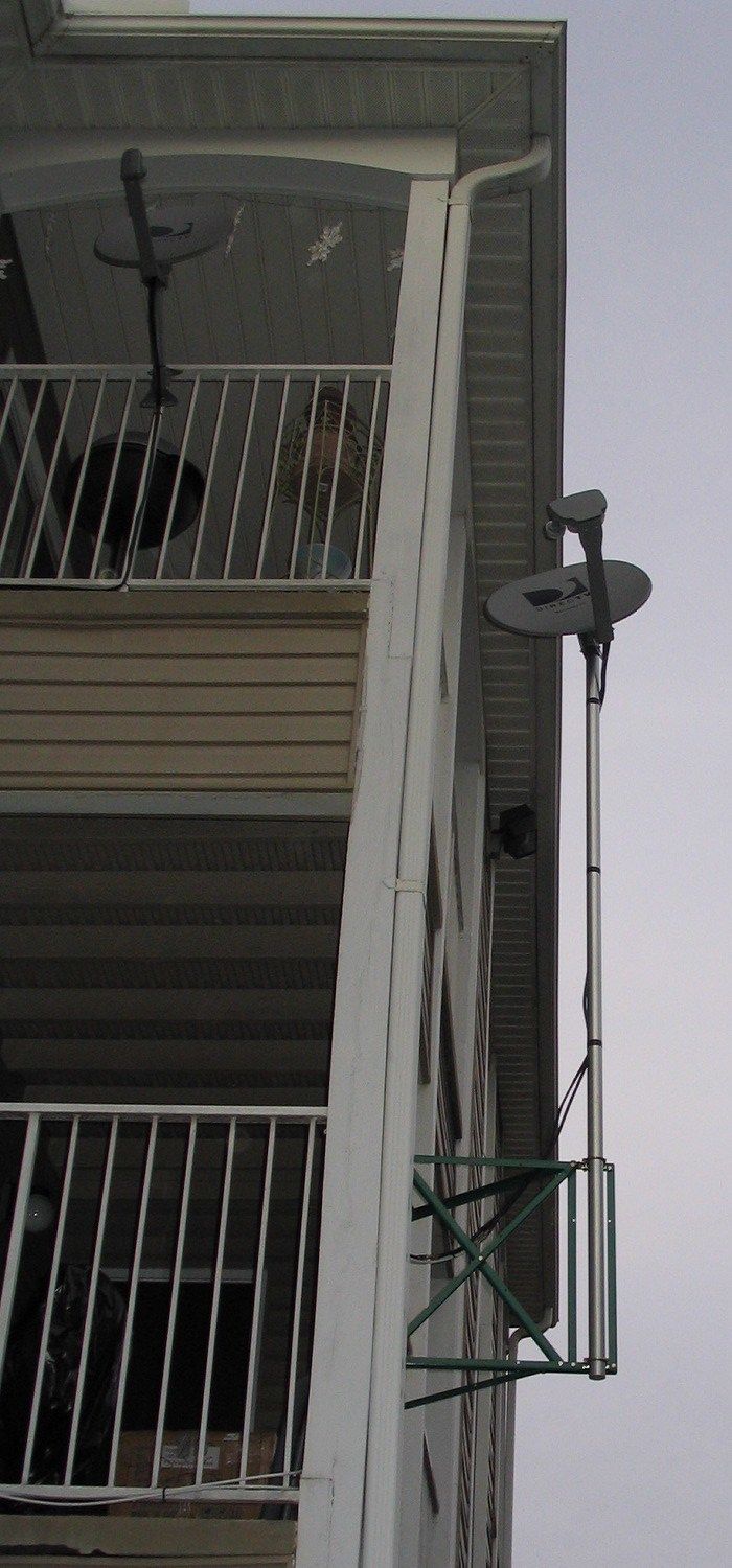

Check out this photo;
There was no chance of asking thet same neighbor if you could possibly mount the dish next to his/hers?
That is not a viable option:
The dish on the floor above is a round dish. Also, where it is installed, it might be doubtful whether if the mounting position would allow access to 119W.
Also, I have found that it is better to NEVER mess with any one else's system or attach anything to it. When I was in both the auto repair and computer business, people, out of NOT KNOWING or BASICALLY IGNORANT of technologies, tend to quickly blame anyone who works on the system for problems, even if they are not the cause of the problem. If something was to fail in the upstairs customer's system, he or she might likely blame my customer or me for having attached my customer's system to theirs.
My customer need all four feeds of the Phase III dish. I wasn't about to replace the upstairs person's round dish with a Phase III and install a 4x8 dish.
The mount to the rail is so strong and rigid that it is as solid as a ground pole buried in concrete.
The dish mount violates the complex rules in that the mounting foot is fastened to a balustre with sell drilling screws; another reason I'd not mess with it or even ask.
And, what happens if the apartment changes tenants? Even if the current tenant is agreeable, the future one might not be.
