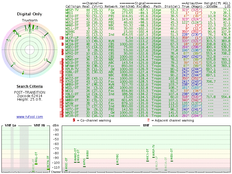

I live in Beecher City, IL, very near to Effingham, IL and about 52 miles from the broadcast location of WAND-DT, our local NBC affiliate. Does anyone else in this area have trouble getting WAND-DT over-the-air? I get WBUI-DT (which apparently is broadcast very nearby) with 75-80% signal strength and absolutely no picture problems, and I get a variety of other analog and digital stations from the Central Illinois area without issue.
WAND-DT, however, will not pick up any signal. I have physically moved my antenna to varying degrees (always pointing north where the station broadcasts) and tried adjusting the amplification, sometimes killing reception of some of the other channels, and still no WAND-DT. As a point of interest, I do pick up the analog WAND-TV, although it is quite snowy and the quality is noticibly worse than the SD feed that DishNetwork gives me.

Looking at TV fool coverage maps,the signal is weak in your area for the analog and digital.The only way to compensate is more antenna,and move the antenna lateral to the signal path if you have the freedom to do so,to find a hotter signal.Their signal favors an East-West coverage over North-South.Actually,they're a real pest here when there's an opening to the West(ie KC)!
