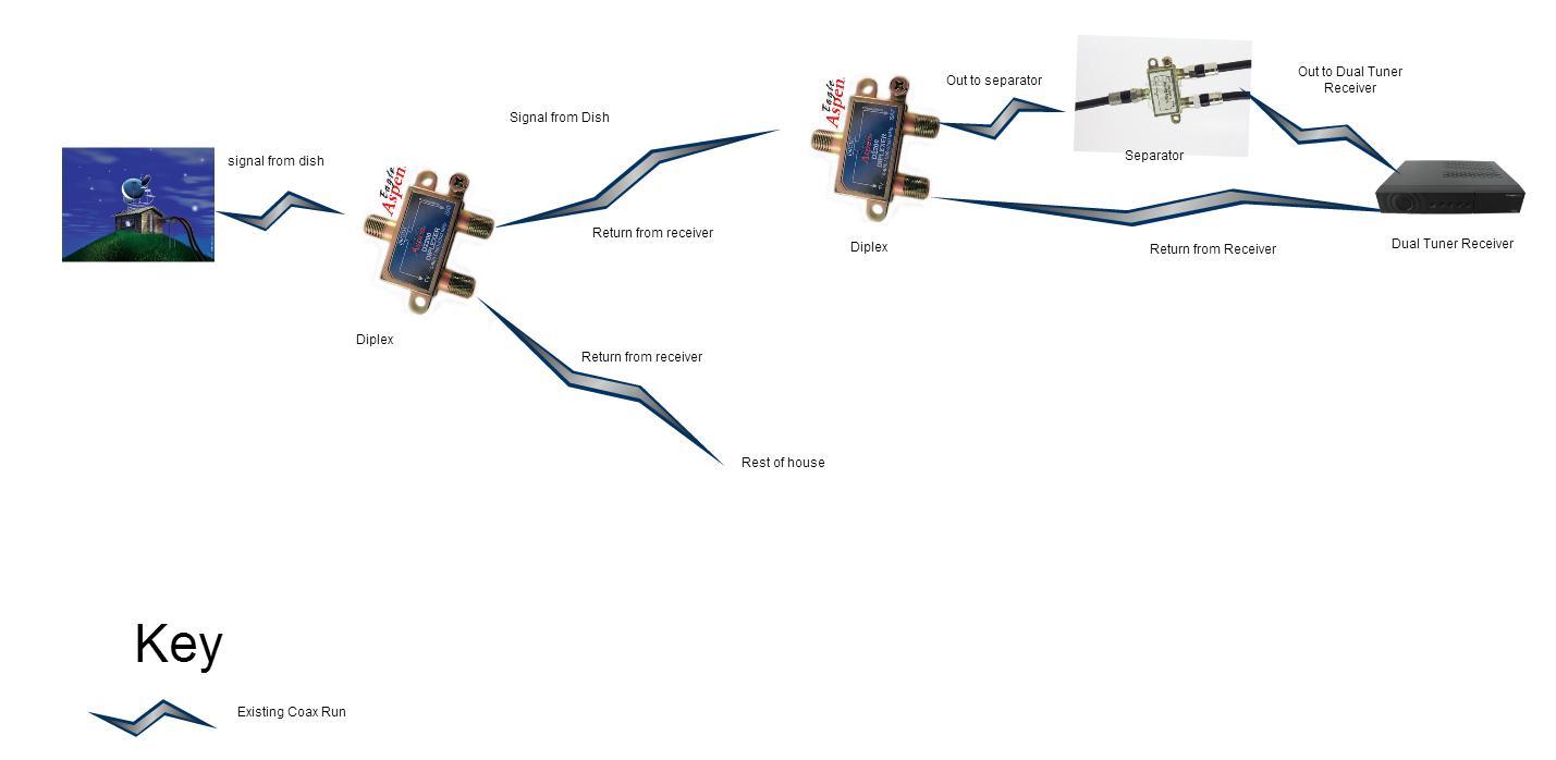

OSU: Thanks for the answer, I have drawn a picture of what I think the A/V network would look like.
A question: Does this picture look right, i.e. where the diplexor's are placed?

no!
that does not look quite right. the first diplexer on the left of the diagram looks backwards sat nees to go to sat. in/out goes to receiver. if it helps to envision it, diplexer always face each other. in/out to in/out.
also, remember that you can run out of the home distribution port behind the 622 as well instead of diplexing. you can also place a splitter there, one line going to 'tv' on diplexer and the other going anywhere else you want.
also remember never to place a splitter anywhere between the path of in/out to in/out. splitters anywhere on the tv or home dist line is just fine. if you hook it up backwards you will know. no signal on receiver and fuzzy picture on tv2.

Your right. Fighting the flu here, I didn't look at it close enough, just glazed over it. The first diplexor is backwards.
Thanks all! Sorry to reply so late but I was out on business. I picked up the diplexers and installed it all yesterday and it works perfectly! Have the Dish setup for 1080i out to the 62" and it looks great. Thanks for all your help, mucho appreciated!
