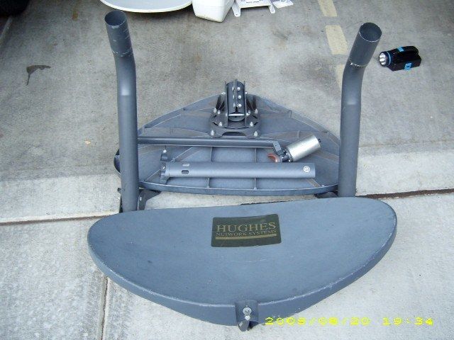

FaT Air - your dish list looks like one I compiled and posted a few years ago.
I like that you added dish-area, a worthwhile improvement.

Well, I recognize this line, specifically:
70e ?? 35x21 Hughes
You have the double question marks, and the 70e that pretty much nobody ever heard about.
I made up the name 70e , based just on dish size.
And it does have Hughes printed across the front size (no idea what they used 'em for).
I don't know what Andrew/ChannelMaster called it.
But, I have two of 'em! :)
Ya did a good thing separating the round from the elliptical, too.
Oh, and adding 90cm and 75cm round.
I didn't think about those at the time. :)
