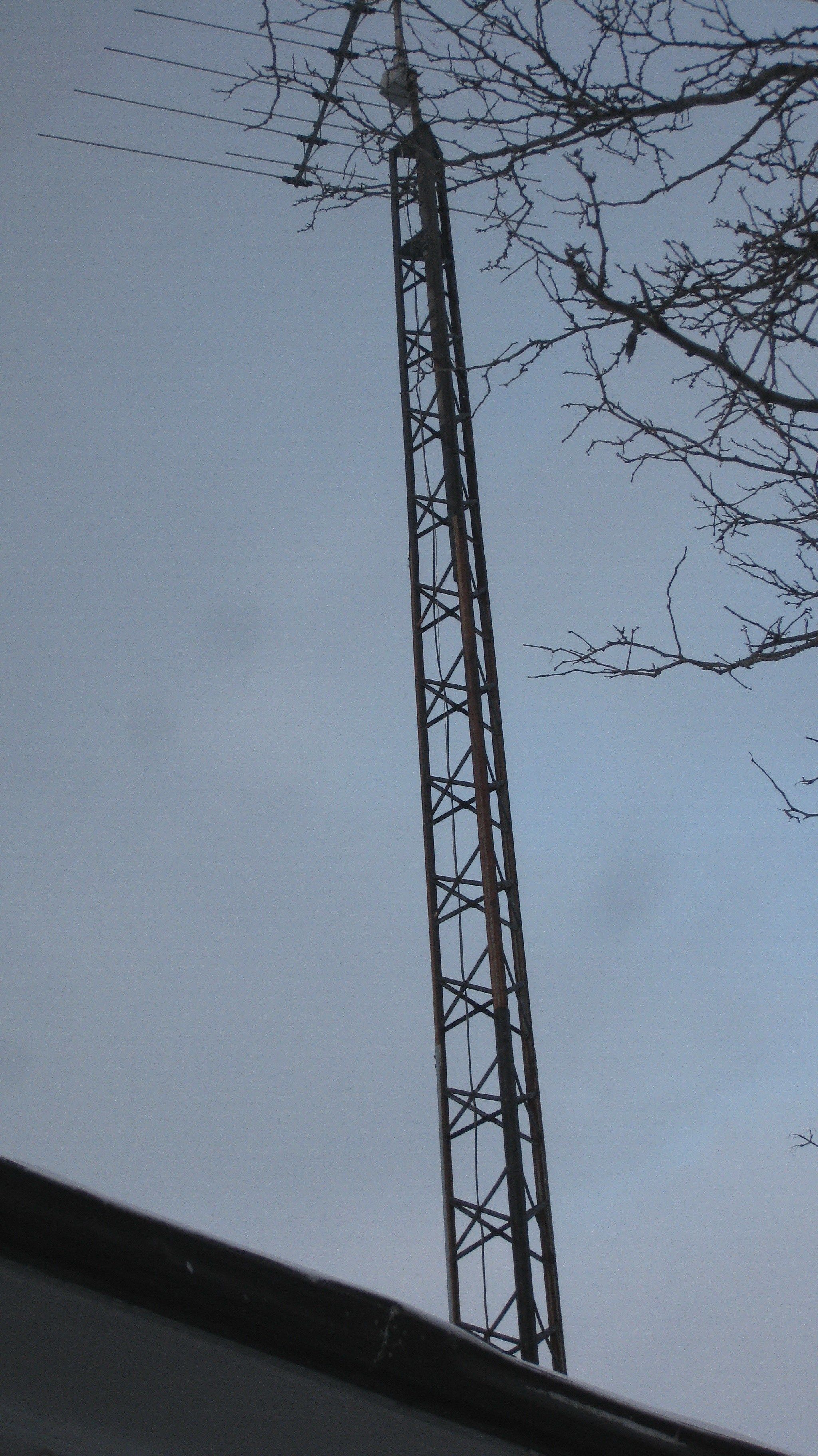

A month ago I called a local installer to change the rotor on my 45ft tower which has a VHF/UHF combo. It was hard to find an installer that would come because it is cold and snowy, but I found one willing to come. Although, it would be $150 for the call no matter what I do, but if I decided they were to do the work the $150 would be canceled.
They came over on a Saturday and the owner took a look at my tower. This was like 3pm (1.5 hrs before dark). He said he didn't consider it safe to climb because it showed rust and the cross-bracing could give. He recommended a chimney mounted antenna (Delhi SFA-1483S "Super Flying Arrow") with rotor and because we are close to Buffalo we didn't need the height like we used to. I gave the go ahead because time was running out, it was really close to dark. Sure enough it was installed (although I wasn't all to happy about the $800 price tag that I was quoted, but it was done and over with).

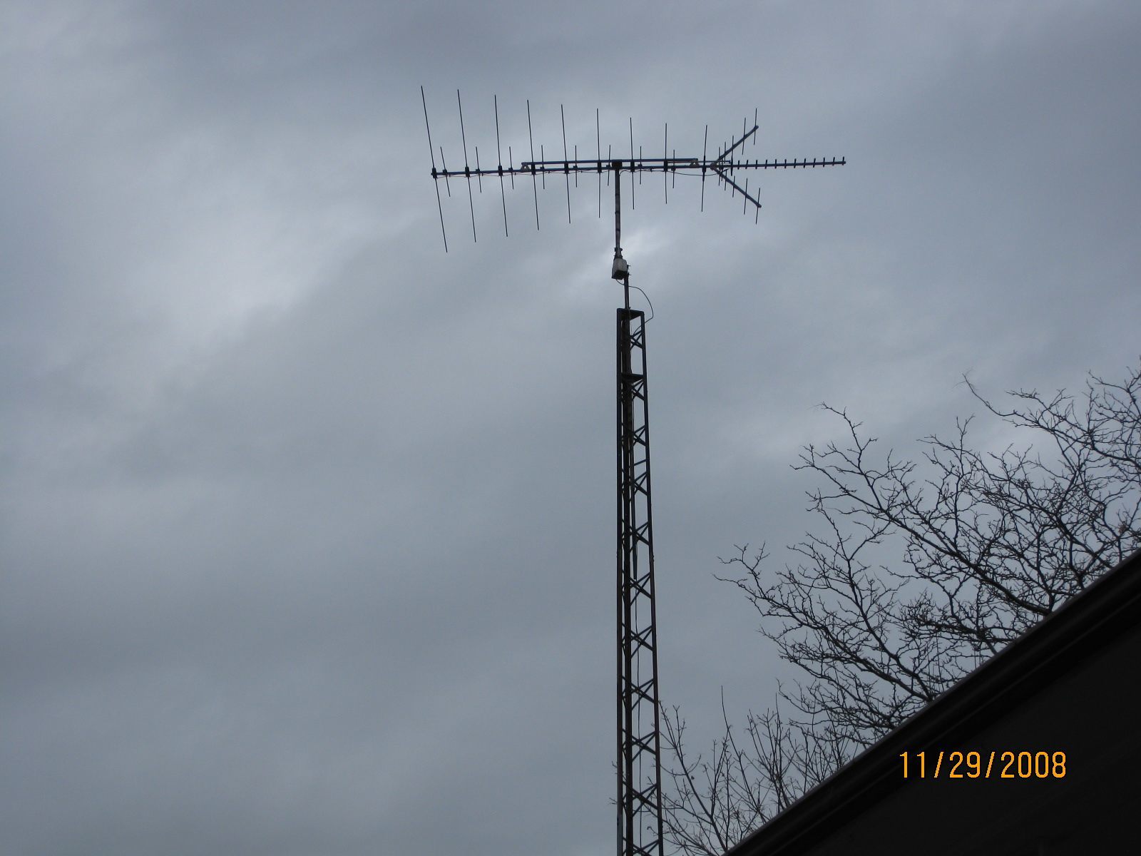

After a week the rotor (CM 9521) got stucked during a resynchronization so I called the installer. That night I had a fire going so I was suspicious that that could be an issue. 2 guys came over and changed the rotor and said it was locked. One told me not to perform a resync because it could possibly lock it again. I was skeptical of that remark. That night I found that as I was programming preset positions in the controller the rotor drive drifted off quite a bit. It would be off 45 degrees from the original preset. But, I had no fire going that night. I would not resync the rotor, instead I would rotate to 000 or 360 to realign it. If I didn't rotate for a while the rotor would take a few seconds to move and drifting it further.
I asked the 2 guys if having a chimney mounted antenna was a good idea because I use a wood burning stove quite often. They said I should have no problems and they have perform many installations like this. So I shouldn't worry. But after I read some recommendations on the net, I clearly have concerns and I may relocate it myself in the summer, to where, I am not sure.
Here are pictures of the old tower and the new installation on the chimney. Any help or comments are welcome.

The rotor appears to be 2-3 ft from the top of the chimney, probably sufficient distance for the heat to be diffused into the atmosphere so as not to be detrimental to rotor operation.
Yeah, but the intense heat diverted by the chimney cap is aimed right at the mast & wires. Add a metal heat deflector or at least make sure the wire is on the side of the mast away from the chimney cap
I checked the wire and he installed the wire away from the chimney on the mast. The slack for the rotor appears to be just over one side of the cap. This may be a problem. I do agree with others here that the chimney is 40 years old and chimneys are not meant to hold installations like this. This was a quick and dirty way for the installer. It happened so quick that day and after all that was said and done I realized this is not what I wanted.

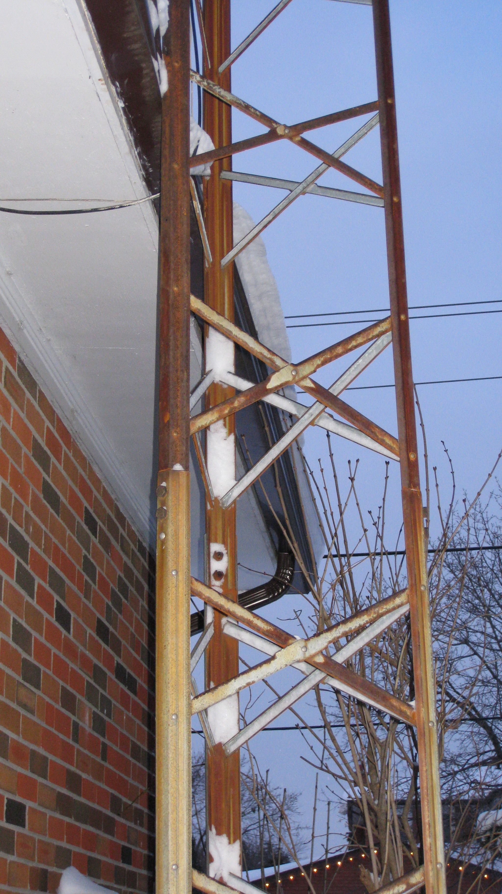

I am thinking about installing a small tower on the corner of my house. I found a supplier in my area. I can still make good use of the wire installed because the tower will be closer to the entry. As you can see from my pictures, the best place to install would have have been my existing tower. But, 2 installers (including this one) came and said they wouldn't climb the tower because they think it is unsafe. A new tower like this will cost $5k, which is a hell of a lot to pay for 20 channels. Although with a 45ft tower I could frequently get Rochester, NY due to tropo affects we get here.

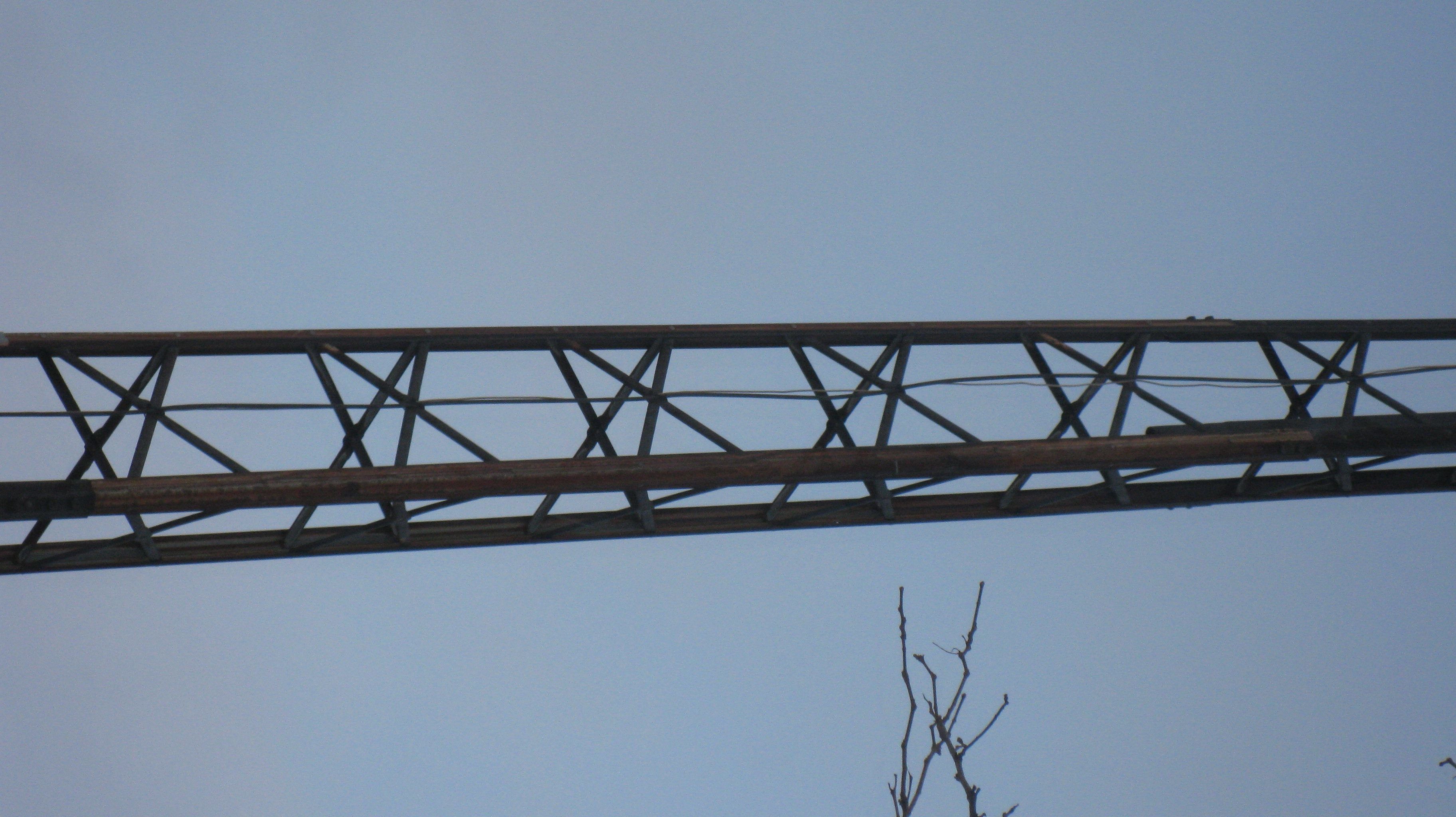

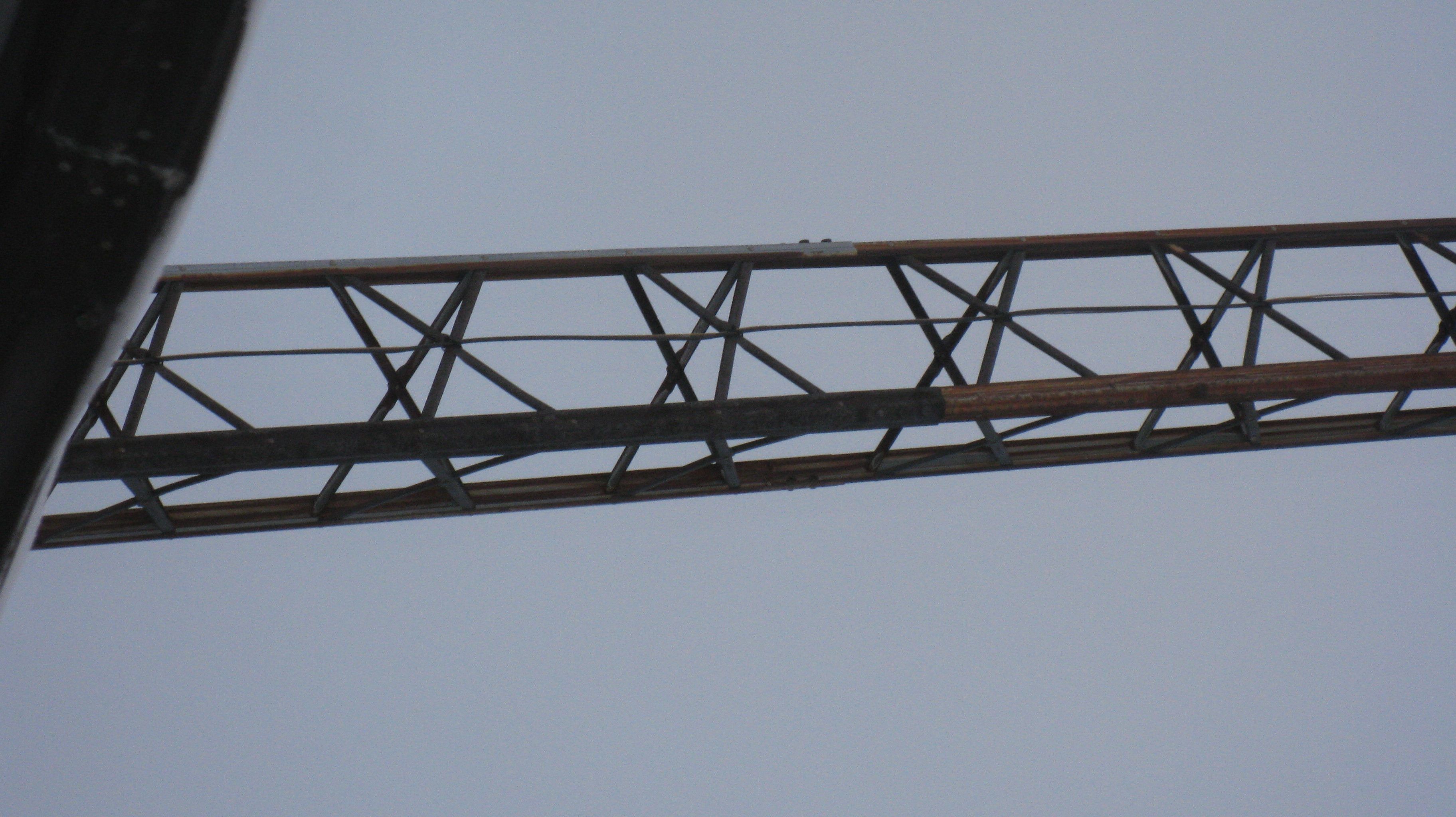

Could you include some photos of the rust on the tower. The tower appears to be galvanized, so it would be unlikely that it has become unsafe for installation. Most installers do not have experience or own the proper safety gear to climb. It is a likely bet that it was easier for them avoid a climb by suggesting that the structure is unsafe.
Just a thought, but would a telescoping mast on the peak of your roof supported by guy wires work? I used one many years ago that was three 10 ft sections that worked well with a rotor and all. That would be much less expensive than a tower plus you could do it yourself and save some major bucks.
Thanks for the response SatelliteAV.
I've attached high res. pictures for you.

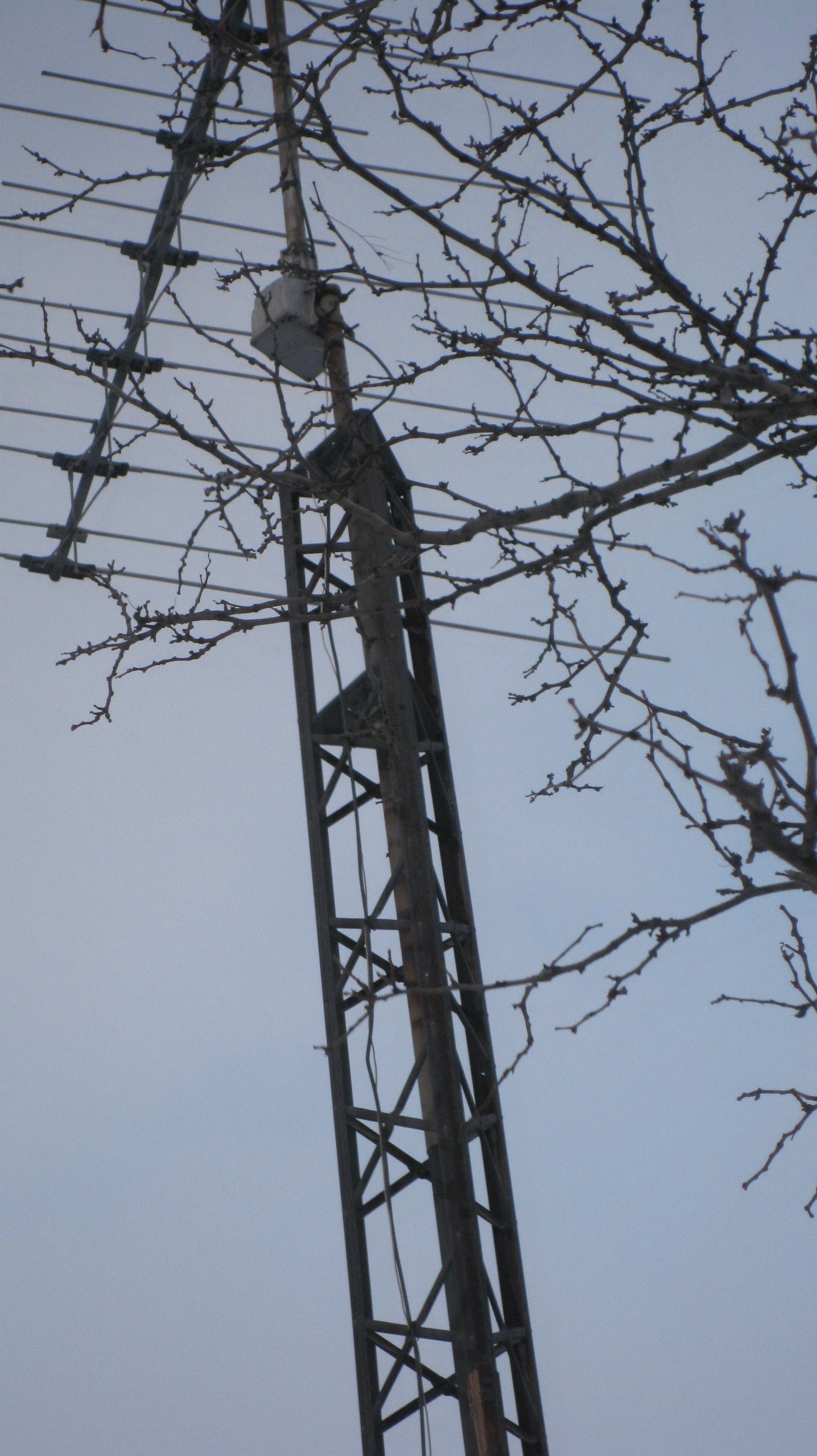

The critical factor in climbing an old tower is the condition of the legs where they meet the ground.Can you get a good pic or comment on this? The tower has some surface rust,but looks ok to climb.The rivets are Aluminum so they can't rust in two.I'd get more opinions on whether it's safe to climb.Temporary rope guys could be used for an added safety margin on the climb.
Yes, these chinese made rotors can be a problem.I'd remove the rotor plate and move it down 20-25 ft,then mount the CM rotor using an L bracket.Then use masting all the way up through the top of the tower.Makes servicing the rotor much easier.Also,heavier wiring seems to help.I buy those cheap outdoor 3-wire 16 Ga extension cords they put on sale this time of the year.Much cheaper than bulk wire and it seems to hold up pretty good.
Here is a picture of the base of the tower. I think that the base is in good condition. Years ago I greased the first 2-3ft to maintain.
I did research on these CM rotors and they are nothing but trouble. I found a supplier up here in Canada I have to get a good one. Thanks for the advice about mounting the rotor lower into the tower. This is a very good option to pursue. Midwestdxer how do you have such good knowledge? :)

that tower looks ok to climb with the proper gear. I beleive your old antenna should be fine, it does not look like it is missing any elements or broke or bent. My parents have a 30' tower with a 30 yr old + Winegard antenna and they get all of their digital locals great even with old rg 59 coax coming off the antenna. When you replace the rotor replace the coax and rotor wire. Also a mast mounted preamp helps a lot as well.

I would concur that the photos do appear to indicate that the tower should support a climb with proper gear. I would also agree that you should snap a photo of the three legs attaching to the base. This could be the weakest link of the tower.

The tower is a Rohn BX tower. I have painted such a tower in much worse condition. It lasted for many years. BX towers are tough on the hands. The cross bracing has sharp edges. Gloves are a must. Even when safe to climb the BX series is still a pain to work with.
I agree that any rust on the base of the tower can't be judged from the pictures.
The tower is located such that an house bracket can be added for an additional safety factor. Part number BXHBU
