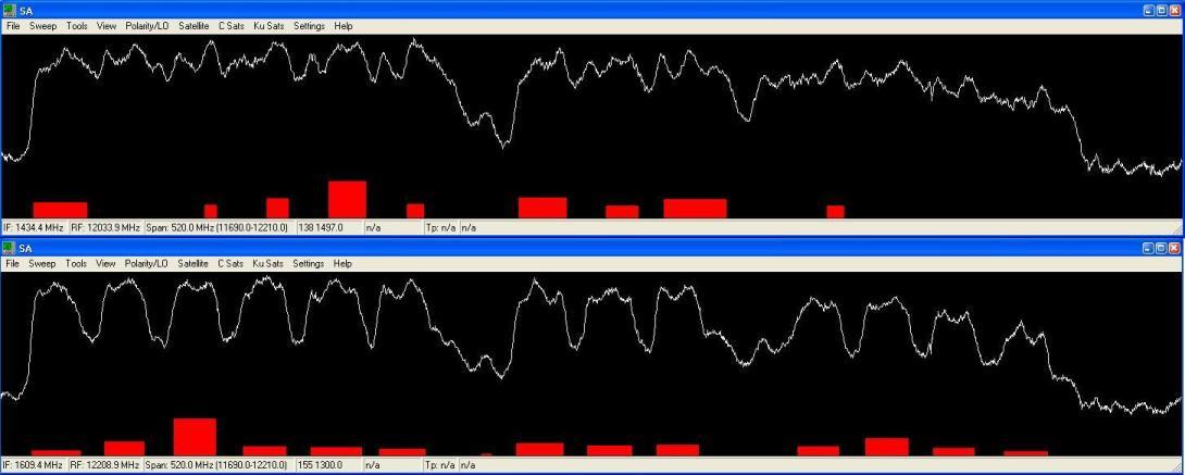

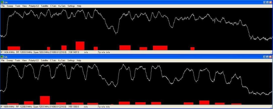

I decided to try a modification, I tried the Fortec Star Universal LNB with two tennis ball can lids cut to the right size and I put it into the "feedhorn" of the LNB. (I think the lid is to thin so a few more layers might help, or a better dielectric plate).
About 150 channels scanned in, only two which were FTA :(. The signal level for the two were at the border line for reception, 66% and 70% on my Coolsat 6000.

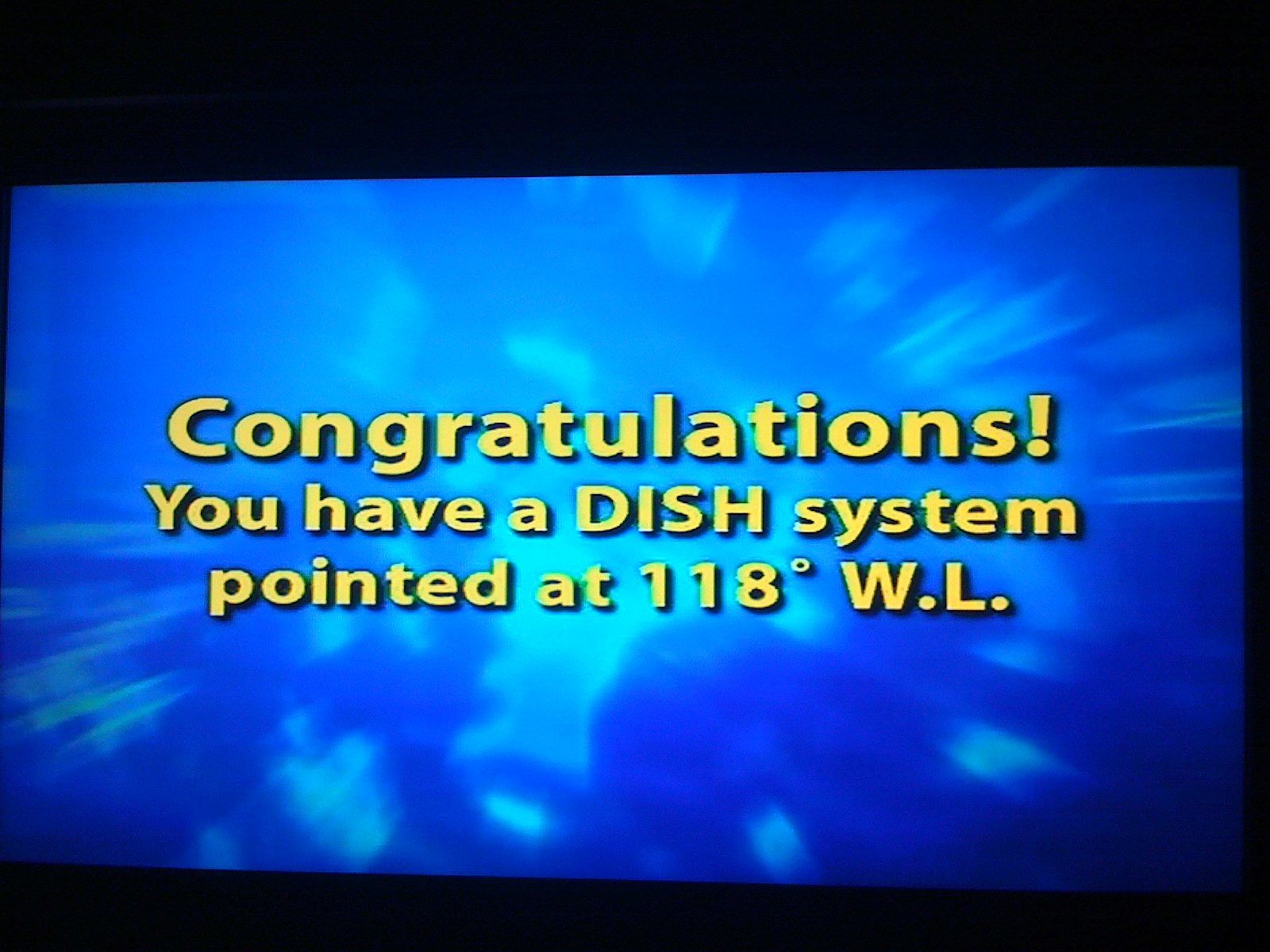

Is the "Congratulations! You have a DISH system pointed at 118 W.L."
EDIT: Attached (118.8 W Vertical / Right) spectrum scans. Top image is the LNB without the dielectric plate, bottom image is the same LNB with the dielectric plate.
The dielectric plate makes a big difference in the spectrum scan! :)

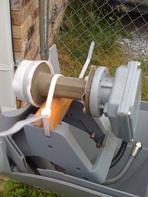

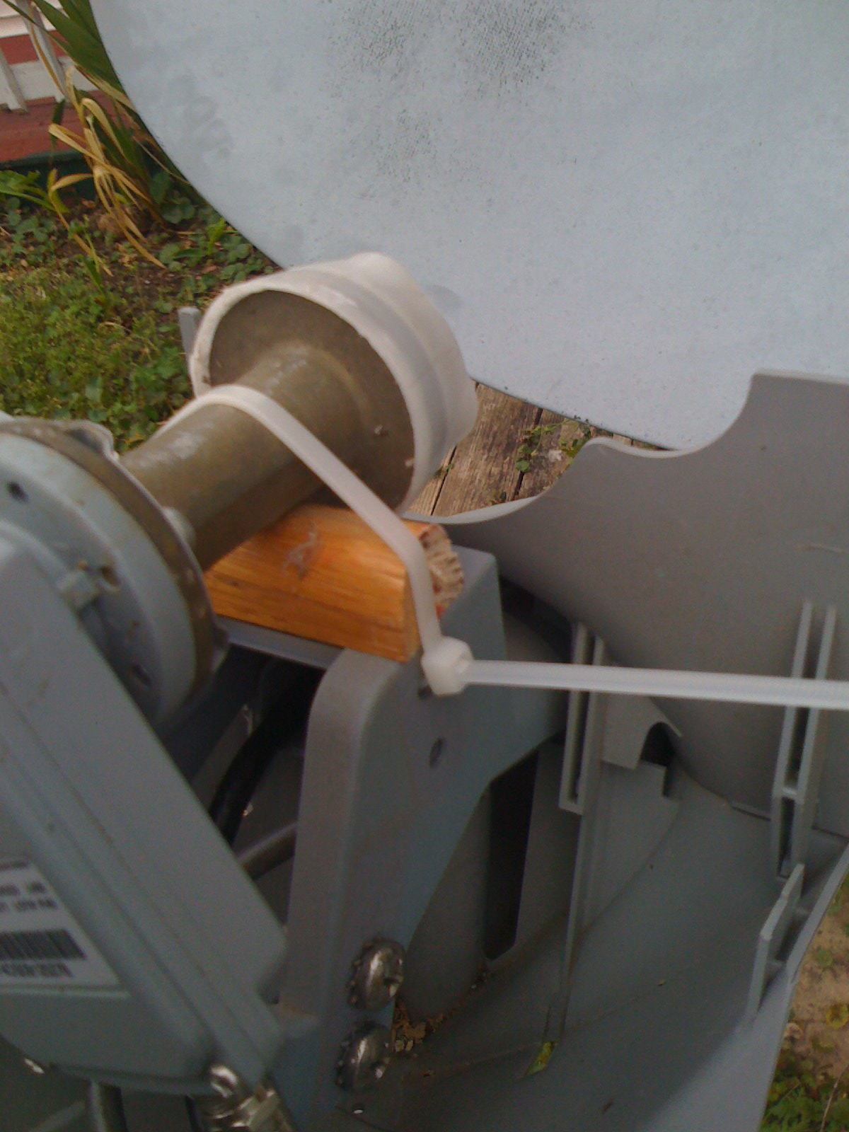

Yup your right only 2, I got it playing around after work. Look at this RIG setup! hehe
My problem turned out being with out those peices of wood, i wasnt in the focal point :-)
