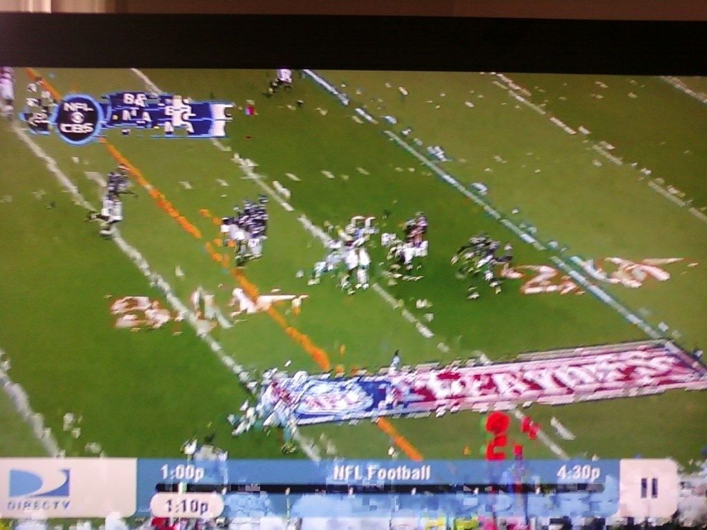

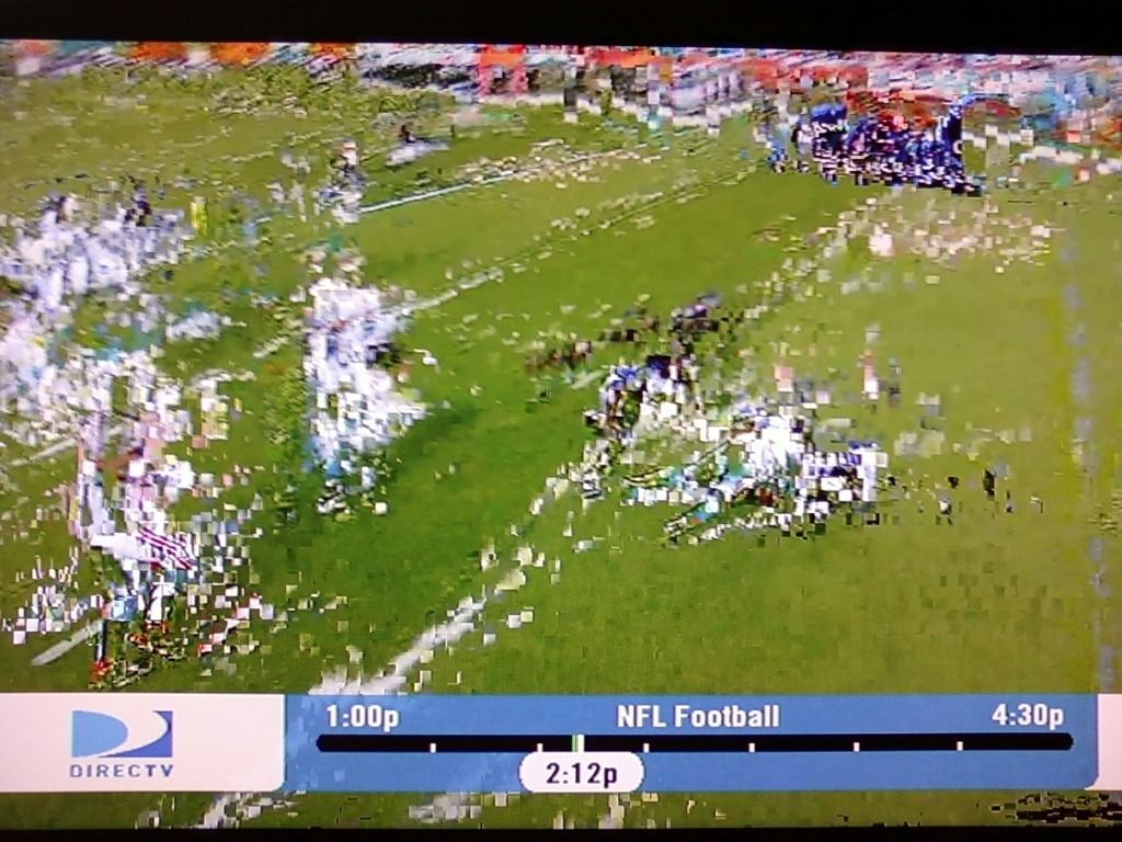

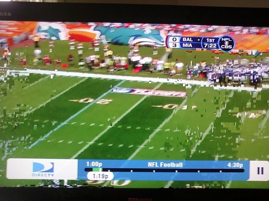

My thanks to HDRoberts for the numbers verifying my claim that the CH 19 signal sucks, and that they are just blowing smoke when blaming others for the problem. I really feel for those who rely on OTA for their CBS programming. They have no idea what they are in for.
Here we go with the scramble and taking hits during a playoff game. This sad sad sad.
