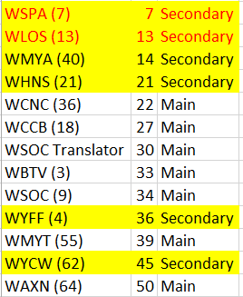

I'm hoping to find some expert guidance from some of you on my OTA situation. I'm trying to combine two different markets (from opposite directions) using two antennas. My primary antenna (w/Pre-Amp) is pointed at the Charlotte, NC market and receives all its' stations. My secondary antenna will be an attic mount, hopefully without a Pre-Amp, or with a very low grade one (as all stations should be "green" for me) to pull in the GSP stations. I realize combining those into one cable has its' problems, so my question is this... can you get custom "notch filters" for multiple channel RF frequencies or would you have to use a separate filter for every channel?
Attached is an image of the channels I'm working with. I know I can easily filter out the VHF channels from the opposite antenna, anyone have any suggestions on filtering the rest on their respective antennas?
What do you want to filter out?
On the secondary Antenna I need to filter the "main" channel signals and vice versa on the main.. I need to block the channels coming from the secondary antenna so the backside versions don't cause interference. I know the vhf channels are easy, it is the others I'm concerned about.
