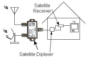

Though I would have like to run Quad shielded RG-6 all over the house, that is quite a task I'm not ready for.
Since I already had several rooms Cable TV ready I just connected the satellite to my existing cable lines and have had no issues, I have rabbit ears for my local OTA but the picture is mediocre at best and I have to make adjustments often.
My cable internet package includes basic cable and I would like to combine signals to a Diplexer so that I can benefit from al the extra channels available, I've included a drawing of the diplexer setup ( see attachment ).
Here's my question, if I add a Diplexer will it allow a signal from my STB to travel back to power my motor and LNB ? Just wan't to be sure.
I can't say for definate as I haven't personally used one and tried to move a dish, but for 1 it'd have to pass the 13/18v for V/H anyway right? and 2, this site shows an EA D-3000 to have a return loss spec. and DC pass spec. http://www.starlink-dss.com/D3000specs.htm

All diplexers pass DC and the 22Mhz tone signals on their Sat leg. I have no experience at using any DiSEqC mini-dish movers, but if they work the way I think they do, then I'd expect them to work with any diplexer.
The problem with the diplexer that brianw20 found is that the cable/ant pass band starts at 40Mhz, whereas cable box and modem return signals can run as low as 10Mhz. The cheap Holland diplexers roll off at 5Mhz, as do several other cheap diplexres.
Don't concern yourself with "return loss". It is a difficult concept to explain, and is generally of no consequence.
