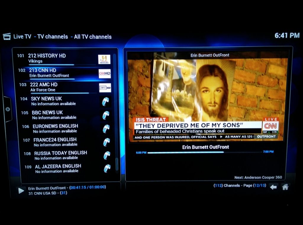

This is near the end of my current list in browse mode with now and next EPG data. CNN HD being previewed and the ones in the list with picons (channel logos) are Comcast Xfinity TV. The ones at the end are IPTV. In the middle somewhere are my ATSC OTA/terrestrial channels.

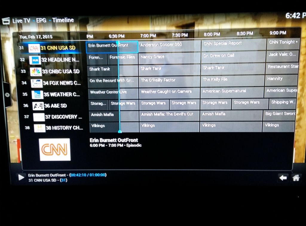

Naturally I wanted a full 14 day EPG. This runs from the FridgeFTA internet server so that I don't have to keep a computer running here for EPG data fetch. I currently have it working for Xfinity TV, OTA and soon I'll add 14 day EPG for my IPTV channels.

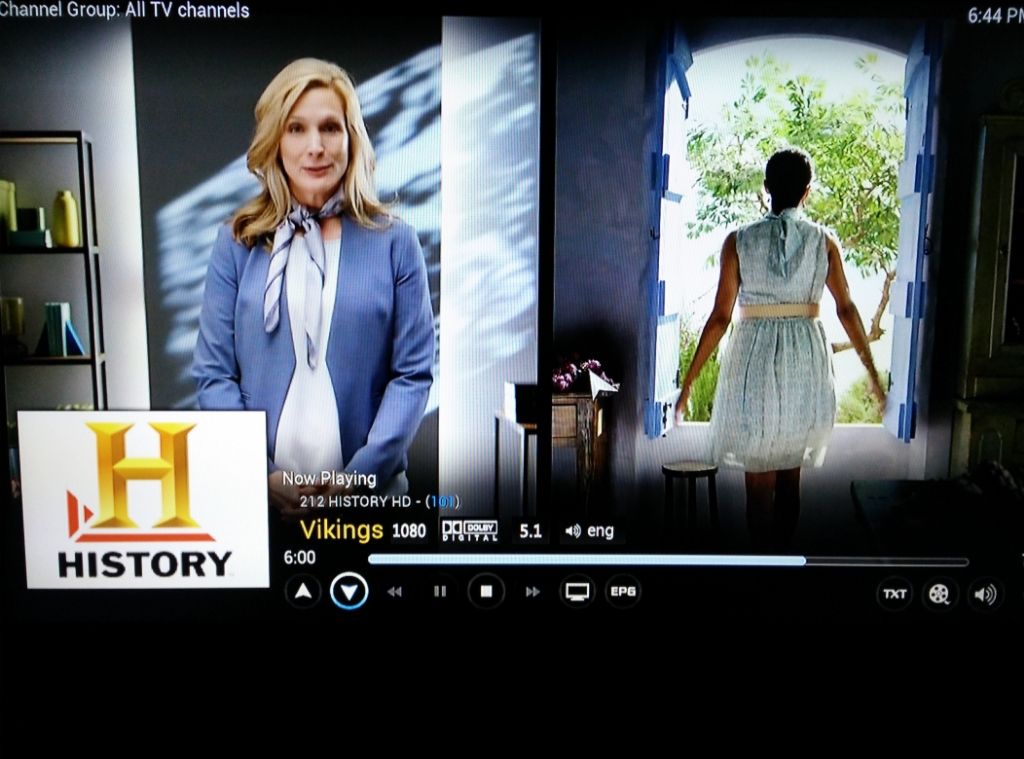

Simple info bar for History HD from Xfinity.

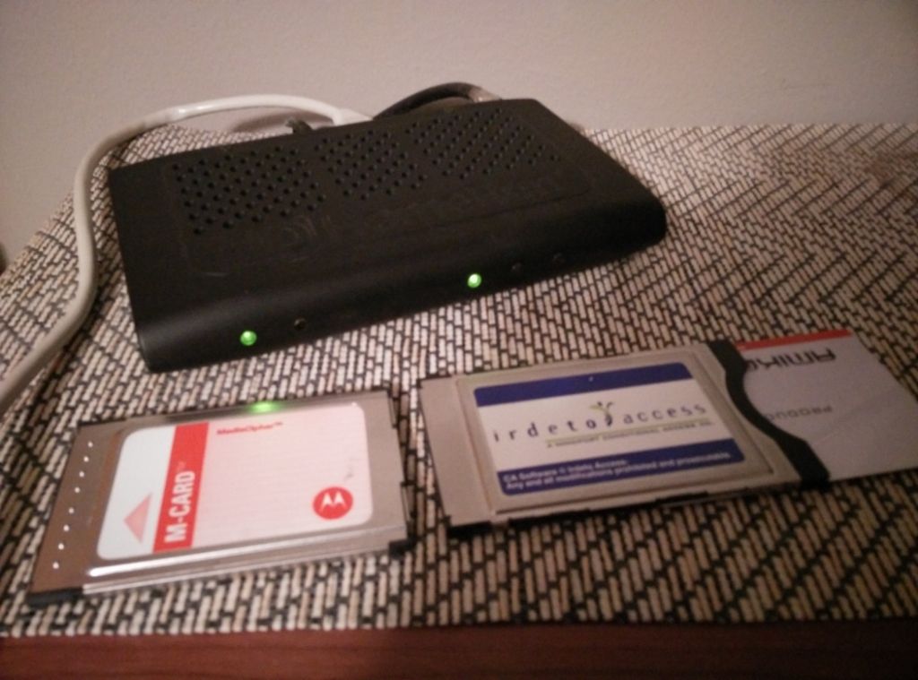

Enter the HDhomerun CableCARD triple tuner. Pictured with it is a M-card (CableCARD) and a European Irdeto CAM/card combo for comparison. This is more or less the same type of system used with European subscription satellite or cable on your choice of receiver. Both are PCMCIA cards that function as decoders/conditional access systems. CableCARD in USA is self contained, it does not use a conditional access ISO7816 smartcard like most CAMs do. Otherwise it is the same thing.
